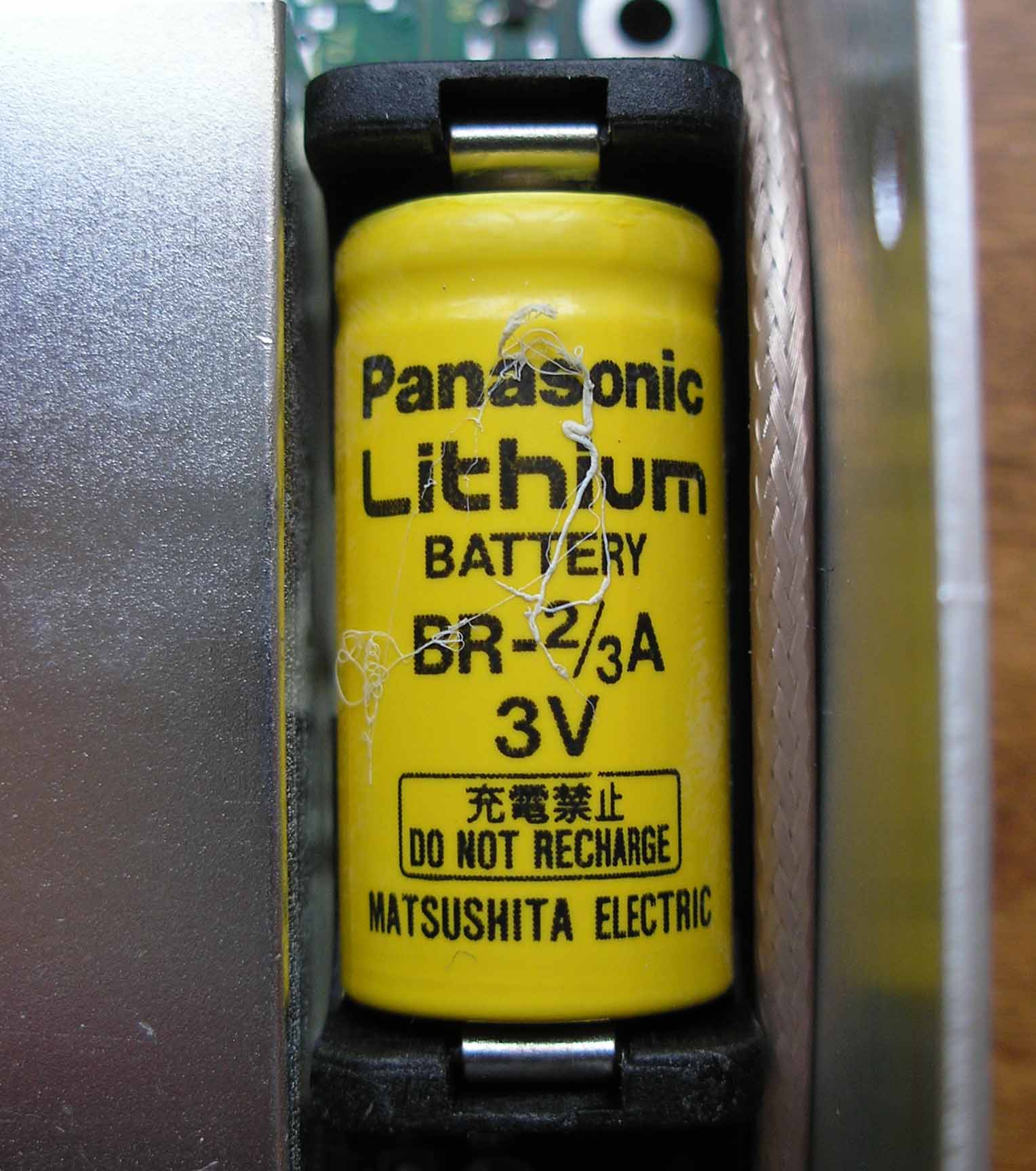

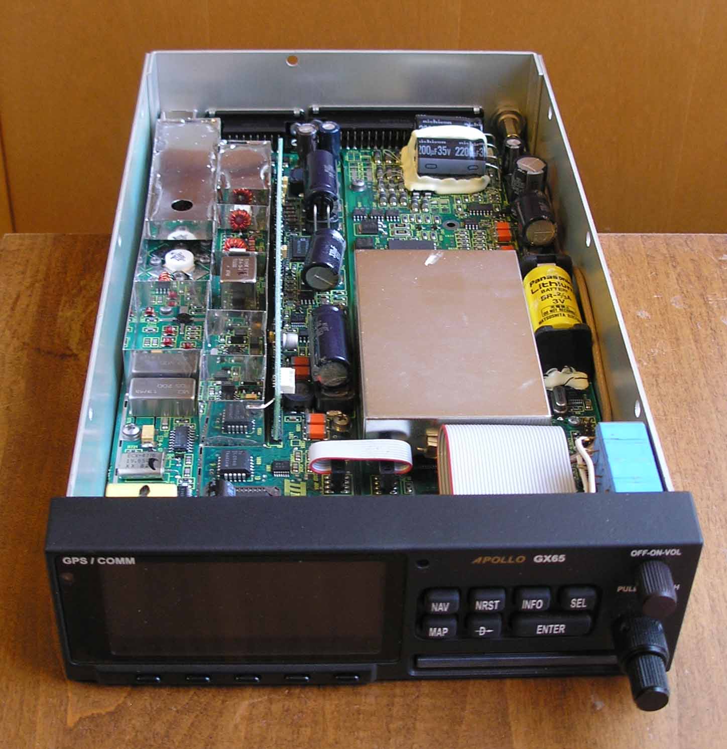

.hmmessage P{margin:0px;padding:0px}body.hmmessage{FONT-SIZE: 10pt;FONT-FAMILY:Tahoma}The Apollo GX series radios also have a battery that the manual says requires FACTORY replacement. THEY have been user serviced. They are in a battery carrier and will pop out with a screwdriver.  I have a coworker that is a T-18 builder / flyer that did his own and set me photos.
Gary A. Sobek
