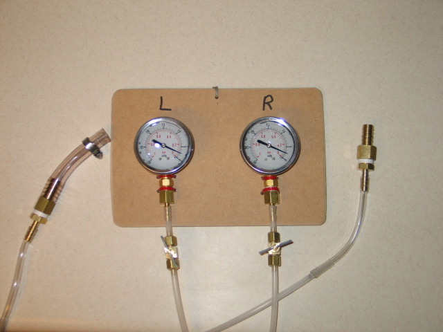

You can prove this to yourself using a dial indicator. Set it up against the outside area around the gearbox (so the motion will be left to right) and let the engine idle at 1400 and then do it again and let the engine idle at 1800. The dial indicator will have less impact and movement at 1800. A big factor in this vibration is as Thom has pointed out that the carbs must be properly synced.
I have posted a picture of a gage set on this forum. It is a liquid filled calibrated set you can put together for about $55 and it is very easy to work with. I Have talked many many people through a carb balance over the phone and you are welcome to call any time. You don't need to spend a lot of money on a balancing system, but just understand what is going on when you do certain things. Each person likes different instruments and tools.
520-574-1080 in Tucson, Az.
A carb balance should take less than 30 min. after you have done it once. It is not something to be afraid of it is relatively easy once you understand what certain things do when you turn a screw or cable.
