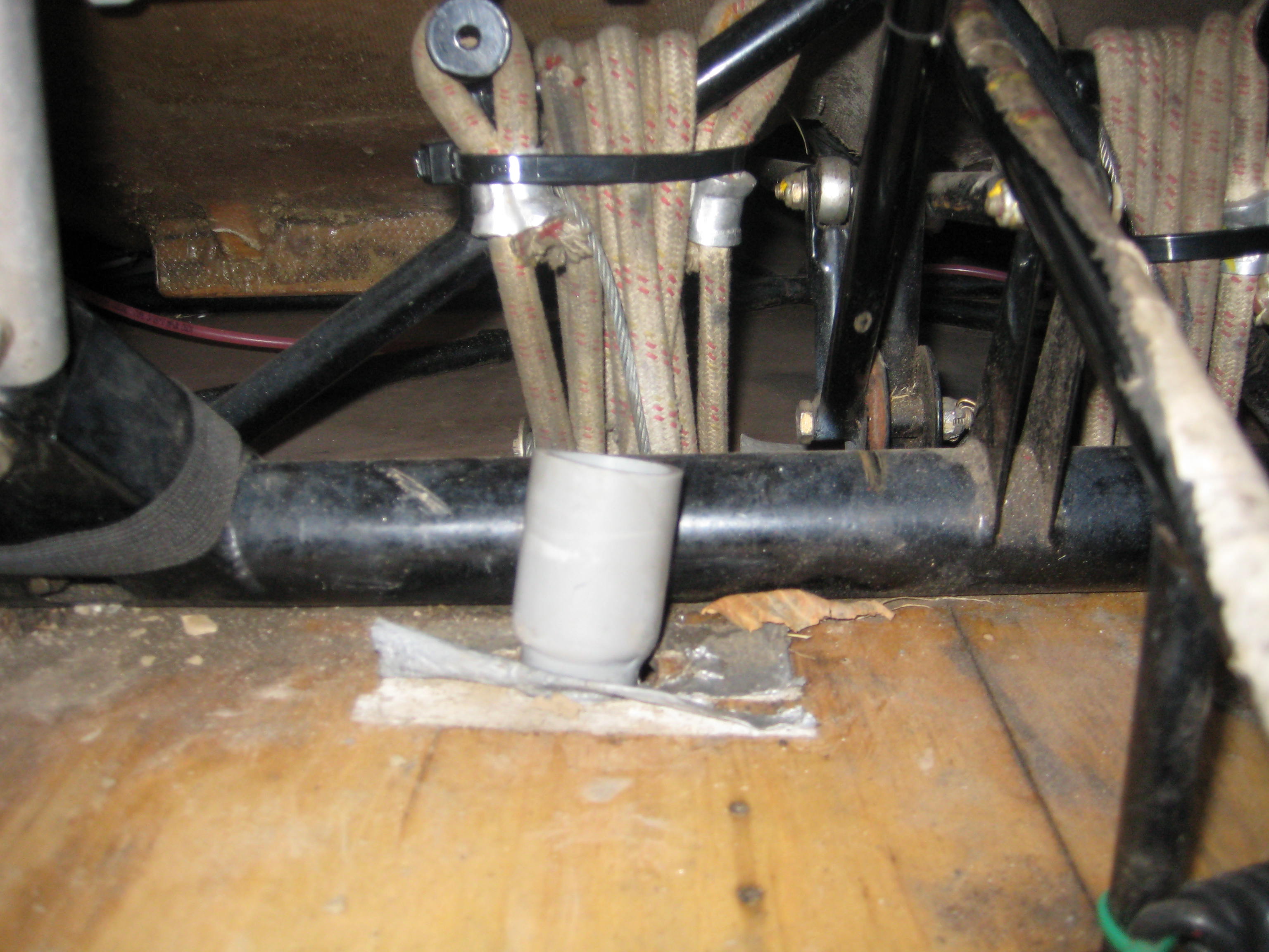

Deke,
Attached is a pic of mine with well over 700 hours on them.
Look like RED RED Yellow ?
Next pic will show mine that are not tight to stops.
I agree-- whazzzzzzzzza all da fuss about ?
Use what works and is proven.

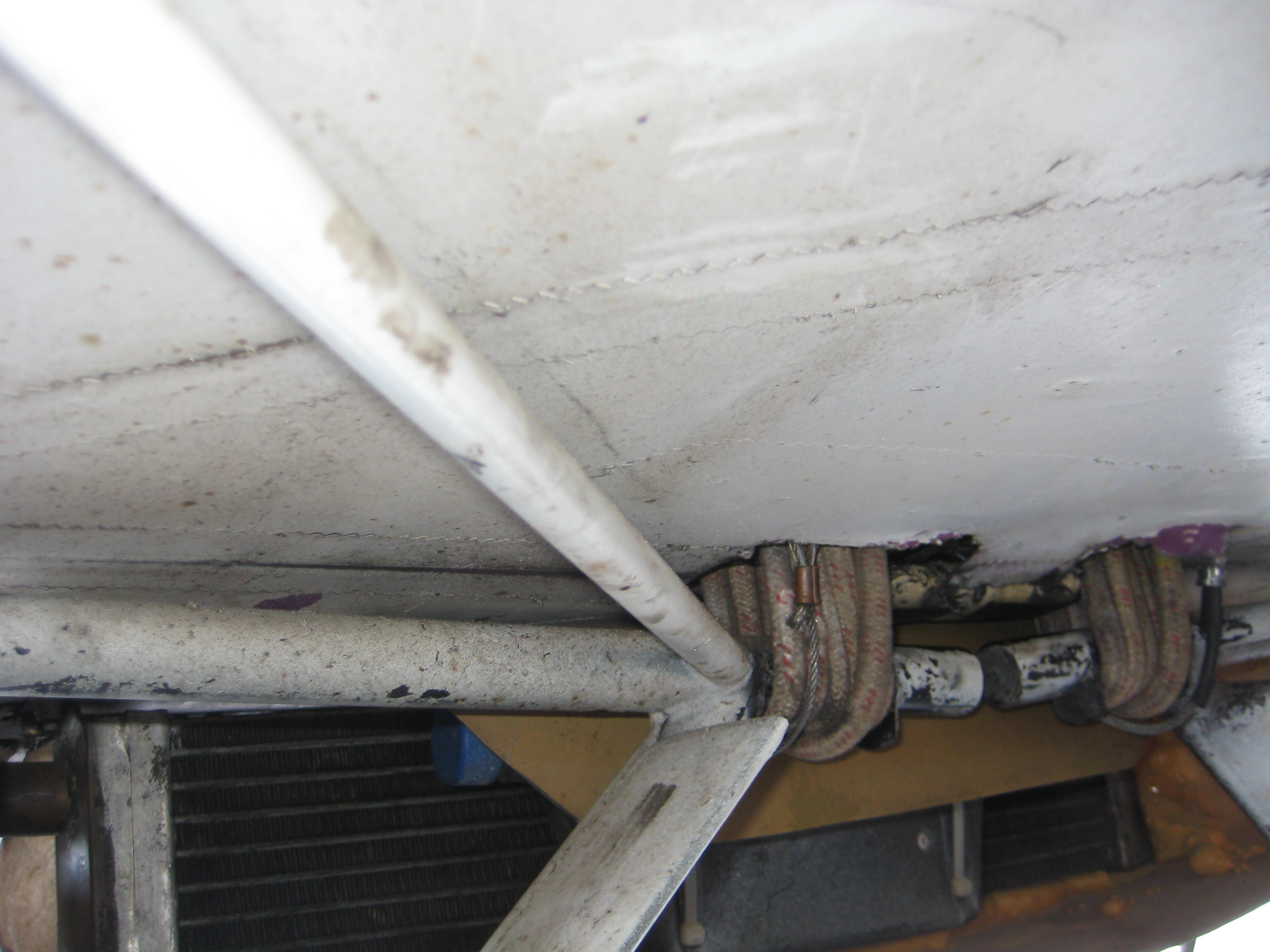

PostPosted: Mon Dec 31, 2007 12:43 pm    Post subject: Re: Shock cords -- FWIW (triv) Reply with quote
Here is pic of Gear not touching stops .
Seems ok so far ,,,,,,,,,, Smile

I think if you want perfection they should be right to the stops, but a
little sag doesn't hurt anything, in my opinion. I notice you use the
safety cables. Many years ago there was a long thread on this subject.
There were reports of some members who made hard landings, hard enough so
that the safety cables maxed out and bent the lateral bulkhead that the
cables are wrapped around. There may still be pics on Sportflight.com
somewhere. If I recall correctly, Skystar published a bulletin recommending
that safety cables not be used for this reason. It's rare for a bungee to
break anyway.

dave
Joined: 22 Sep 2006
Posts: 1382
PostPosted: Thu Jan 03, 2008 1:26 pm    Post subject: Re: Shock cords -- FWIW (triv) Reply with quote
Michel read up a a few posts ........of mine
