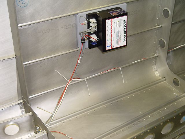

I waited until after I attached the tailcone and found that I didn't need to crawl into the tailcone at all (yet). With the fuselage at the right height, everything is very accessible for my 6' bod and reach. Because all of the tailcone wiring runs forward, my thinking is that it's all easier to do with the fuselage joined. Then you have a good long session of wiring the battery compartment, tailcone, and other stuff.
My approach was to copy the routing used in Van's wiring kit (I didn't buy the kit). That is to run the wire down one of the J-stiffeners. Here's where thorough deburring pays off because you don't won't the wire to contact any burrs. For insurance, I put a 1 inch length of shrink tubing where it passes each bulkhead and then added a small length (3/8" perhaps) of edge grommet to each bulkhead. The grommet work really well without adhesive. It's all tied down with tie wraps. Very neat and easy. Giving the whole bundle a twist keeps everything especially neat. Which is not to say my installation is particularly neat... but I'll do better next time.
I ran wire for the nav light, strobe, pitch trim, and rudder trim (just in case I do the rudder trim later). I holding off on the ELT hoping there will be an experimentally priced solution with the latest tech standard (900mhz or whatever). I'm going with wing tip Nav antenna.
Generally, I'm avoiding conduit for all the initial wiring and only putting empty conduit in for any and all the stuff I'm bound to figure out later. Just a choice.
Attached is a pic but I'm not sure it will post. I can send directly.
Bill "done flying for a while and ready to build again" Watson

PostPosted: Thu Jan 03, 2008 7:22 pm    Post subject: tailcone wiring Reply with quote
Totally agree on both points. Drilling the holes for the ties in the J
channel were not much of an hassle after joining the fuse but would be
easier and done more accurately before joining. My static ports were
done before joining - a good way to go.
