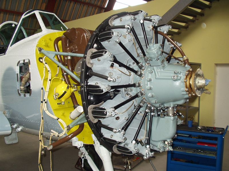

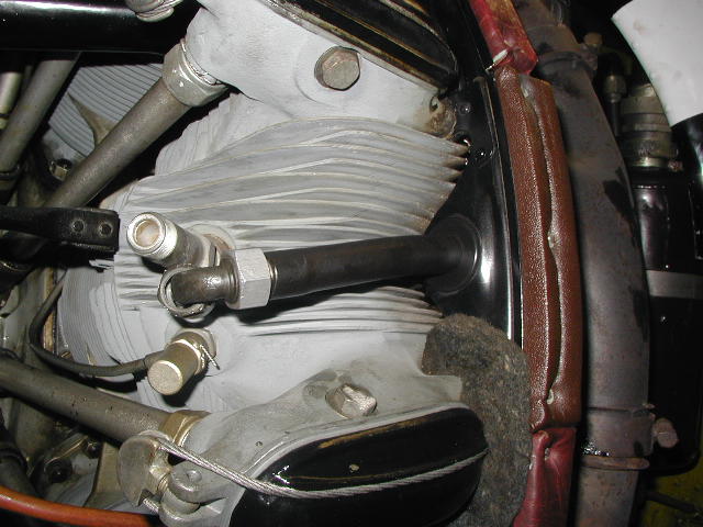

Externally, the cylinder cooling fin castings are different. The Series I engine cylinder fins left and right of the spark plug are basically all the same height. On the Series II engine cylinders, the fins are different heights. The attached photo P413001.JPG is a Series II cylinder. In the second photo, look closely at the cylinders. You can see the fins are the same height. This is a Series I engine.
