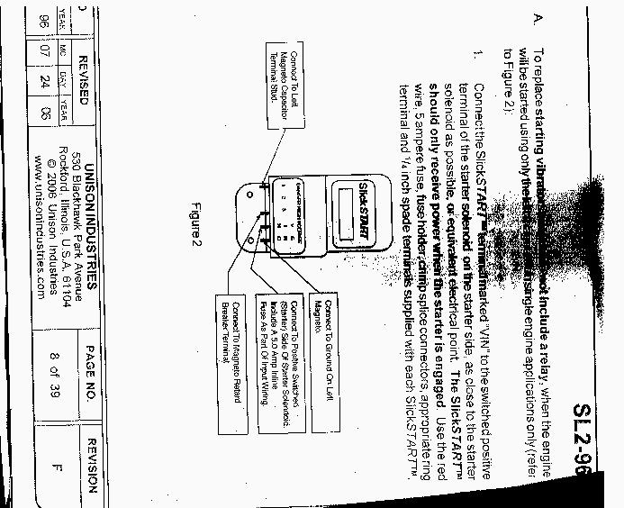

mckervey(at)edge.net Guest
Posted: Mon Feb 04, 2008 7:13 pm Post subject: Slick Mags |
Bill,
The new Slick-Start doesn't have a pin 2.
Joe
| Back to top |
Posted: Tue Feb 05, 2008 8:55 am Post subject: Slick Mags |
[img]cid:002f01c86817$0d4596a0$27ae9804(at)josepheg3rzhs5[/img]
