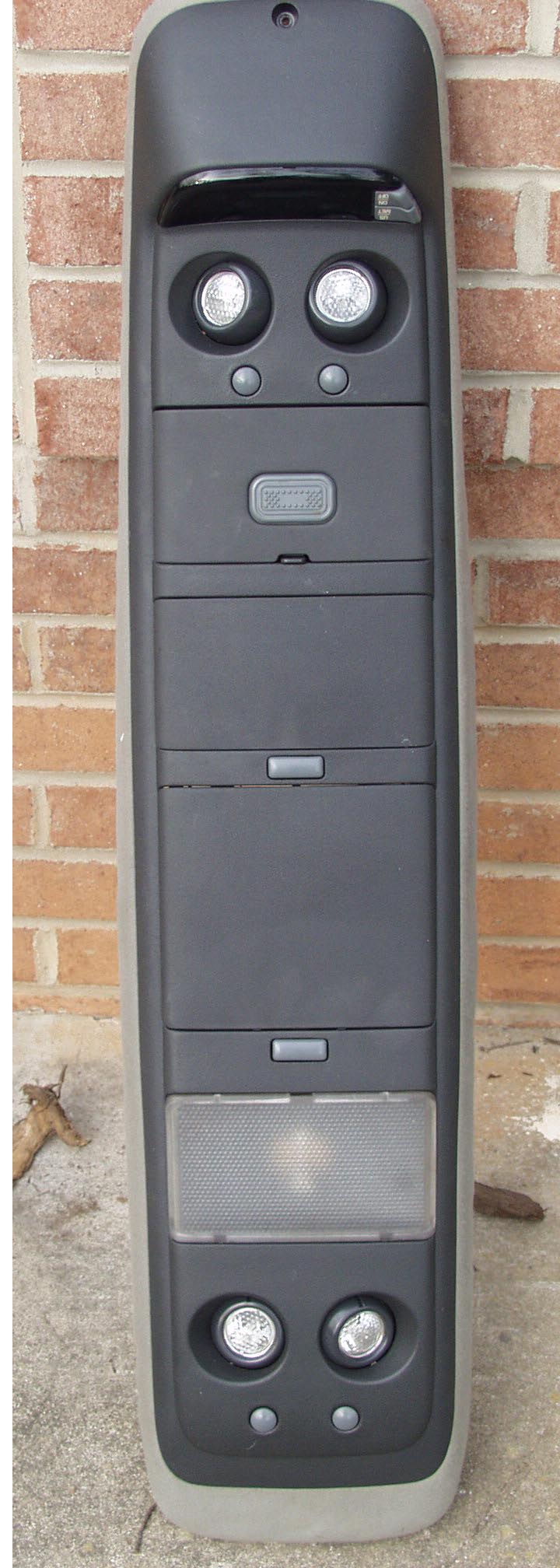

Lew Gallagher
Joined: 04 Jan 2008
Posts: 402
Location: Greenville , SC
PostPosted: Fri Feb 15, 2008 6:39 am    Post subject: Re: AA Overhead console retrofitting Reply with quote
About overhead consoles: I went to the junk yard and picked up the overhead out of a late model Chevy Blazer last weekend (it comes out with three screws) -- complete with wiring harness, front and rear left/right spots, three compartments, dome light, AND apparently a compass and temp display ... for $25. For that, I'll make it work!
Later, - Lew

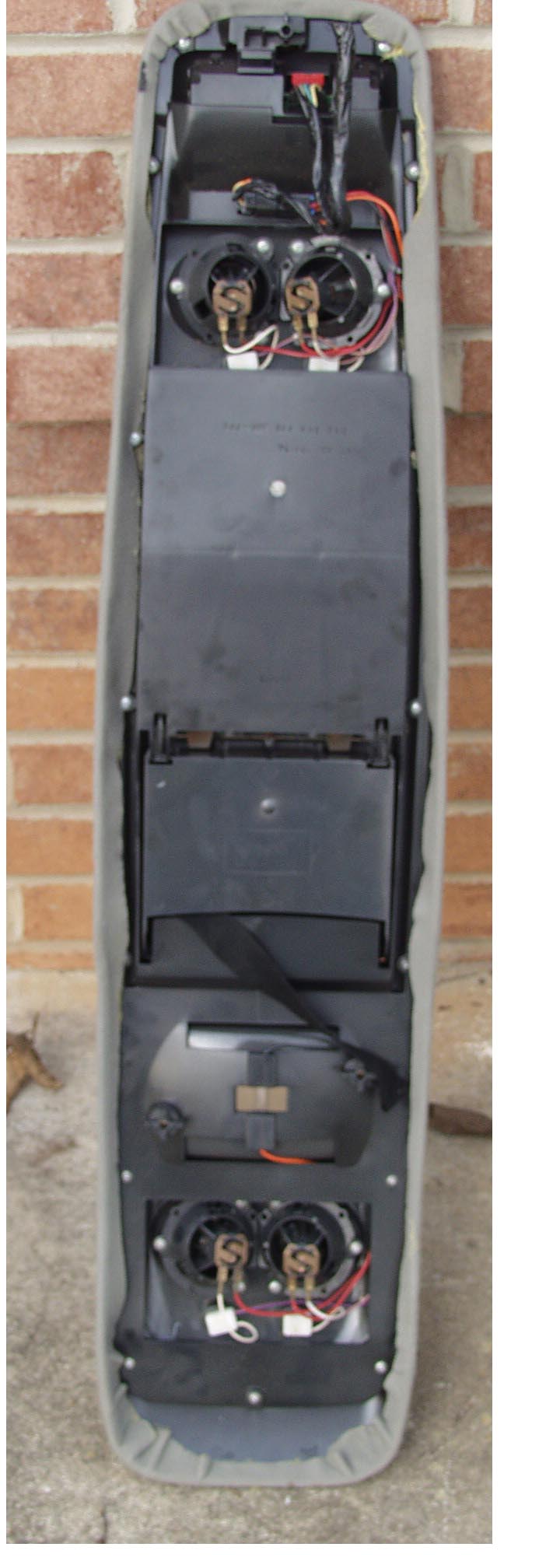

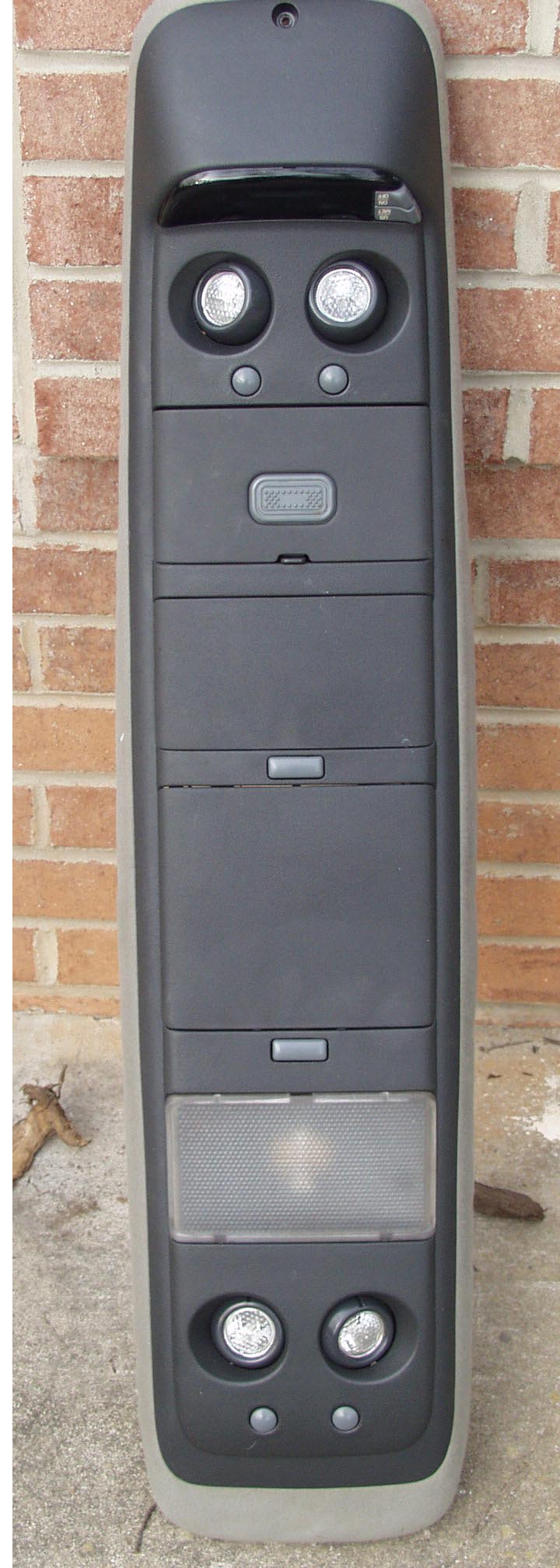

Lew Gallagher
Joined: 04 Jan 2008
Posts: 402
PostPosted: Sat Feb 16, 2008 4:26 pm    Post subject: Re: AA Overhead console retrofitting Reply with quote
OK Jack, I took my digital postage scales over and weighed the Blazer console -- 4 lbs. 4 oz. That's as is, probably could be stripped down some. I'll attach a couple of pictures.
Here's a comment I think is worth sharing from Paul:
"Hi Lew,
We have the overhead console you describe and I was very excited by the prospects of outside air temp display but my bubble was burst. It seems you also need the vehicle ECU to handle the input from the RTD probe and the output to the overhead display. I learned a lot about it by searching the web. I still really like the console, though. I swapped out the resistive filament bulbs with LED's and have the current draw down to less than .1 amps.
Paul Hahn
#40203"
