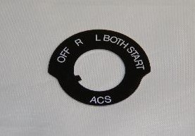

OK, Sam,...I give And I'm sure this is beginner stuff but are you saying that the hole in the panel should match the hole in the trim ring with the internal tooth? See picture. If so, how do you drill a round hole in the panel leaving an internal "tooth" to fit the slot on the barrel of the switch? The barrel is like a big toggle switch but without the key/tab washer to keep it from turning.
The internal tooth on the trim ring positions the trim ring to the switch positions but I have no idea how you would make a similar hole in the panel to mount it in without a lot of work or a CNC machine. With the bezel nut reasonably tight, mine won't turn but then it's not flying/vibrating yet either.
BTW, there was no lock washer or locking tab with my switch that I remember? If I'm missing something here, I need to fix it!
Thanks Bill S

Bill, trace the inside of the key switch plate onto your panel. You need to make a hole "smaller" than the final cutout. The tooth is created manually by filing/cutting/whatever method you choose. It can take a lot of time and is finicky but use a step drill to cutout the major portion up to the internal diameter of the tooth. Create the tooth or "tab" by enlarging the hole with careful filing either side of your tab outline that you drew onto the panel. It doesn't have to be a masterpiece, as the hole is neatly tidied up and covered by the switch plate.
The switch should come with a switch plate, a hexagonal rear locking nut and a screw down circular face at the front.
John 40315
