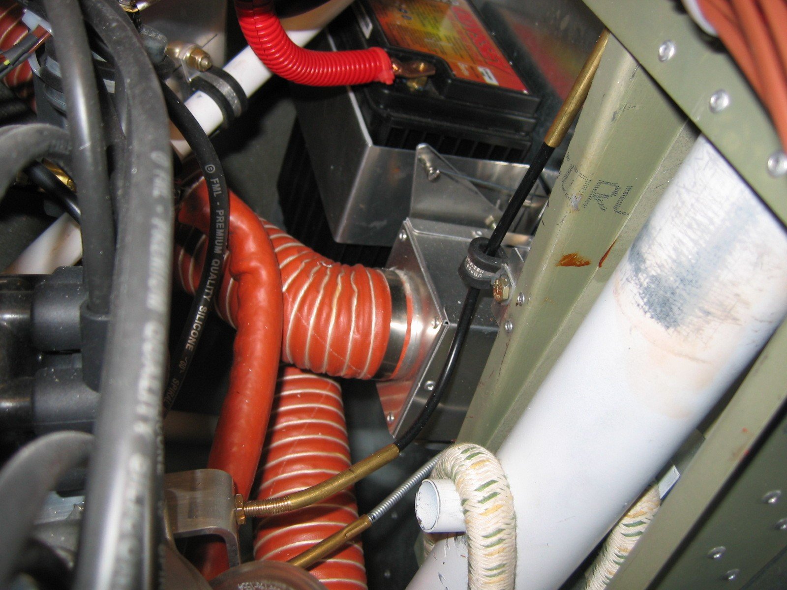

Not sure if you have seen the new Homebuilthelp.com Zenith 601/Jabiru installation video, but it gets covered there. Jabiru recommends bending the brass cable-end adjuster to help accommodate the bends the cable is required to make. I am putting in the dual throttle which also requires bending around the center structure. Although not the best view, I attached the only picture I currently have showing the bent adjusters at the carb for both throttle and choke.
Good luck,
 Filesize:  298.97 KB
 Viewed:  710 Time(s)
