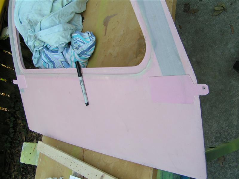

toaster73(at)embarqmail.c Guest
Posted: Thu Mar 13, 2008 6:04 pm Post subject: Door fit |
Robert,
Someone wrote before that "the fit is right when you are tired of sanding and re-filling and sanding" perhaps that was Deems. I made a couple of mods to the process for initial fit.
1) I glued (with super glue) two strips of trimmed door glass to the outside of the door, fore and aft where the two protruding alignment tabs are. I match drilled through the tabs into the glued on piece. THen I cut the tabs off. That allowed the door to begin its journey into flush fit with the canopy. As I took the door on and off it would go pretty much right back to where it was every time. See photo.
2) After I got the fit pretty darn good I mixed a thick epoxy/flox and spread it over the door and cabin top at the joint until I had a nice surface together. I did this just in a couple of areas that were troublesome. This mixture would not flow at all and this was with hinges on but no door seal. I then lifted the door open slightly so it wouldn't all glue together. Yes, it did pull a little ridge of the mix up but not much if done careful.
After it dried I just knocked of the ridge with the sanding block and I have a razor like fit. This is with a 45 degree style door. I also coated the 45 degree portion of the door with pure epoxy to give it durability.
I'll revisit the fit with the door seals on, those just arrived . I am trying the ones from Aviation Tech Products.
The alignment tabs supe glued on are easy to pop right off and then sand away the residue. Don't need much glue either just a couple drops.
-Chris
#40072
