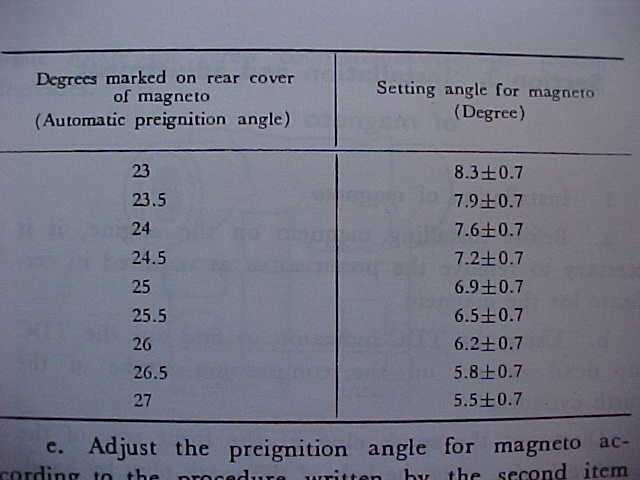

I'm looking for input on what tool is best to use to time the Mag to
engine.
I have the directions, what I don't have is the tool.
I understand that the Chinese tool is just a TDC indicator ( I don't
have one this is just hearsay) .
I can find TDC with a screwdriver..
Does anyone have info on a tool that I could buy or make or adapt or ???

You can use the following two instruments. One is a magneto synchronizer
which you will need to time and synchronize each mag. The other which is a
timing disk that mounts to the prop dome or spinner and is used to read the
timing degrees after you establish #4 cylinder at TDC. As a reminder, the
number stamped in the boss of the magneto under the cover is to be
correlated to the proper number of degrees in the Huosai engine timing chart
(see attached).
http://www.aircraft-tool.com/shop/detail.aspx?PRODUCT_ID=E25&ReturnPage=/shop/search_result.aspx?PageNo=1
http://www.aircraft-tool.com/shop/detail.aspx?PRODUCT_ID=LED52&ReturnPage=/shop/search_result.aspx?PageNo
Hope this helps.
Dennis
