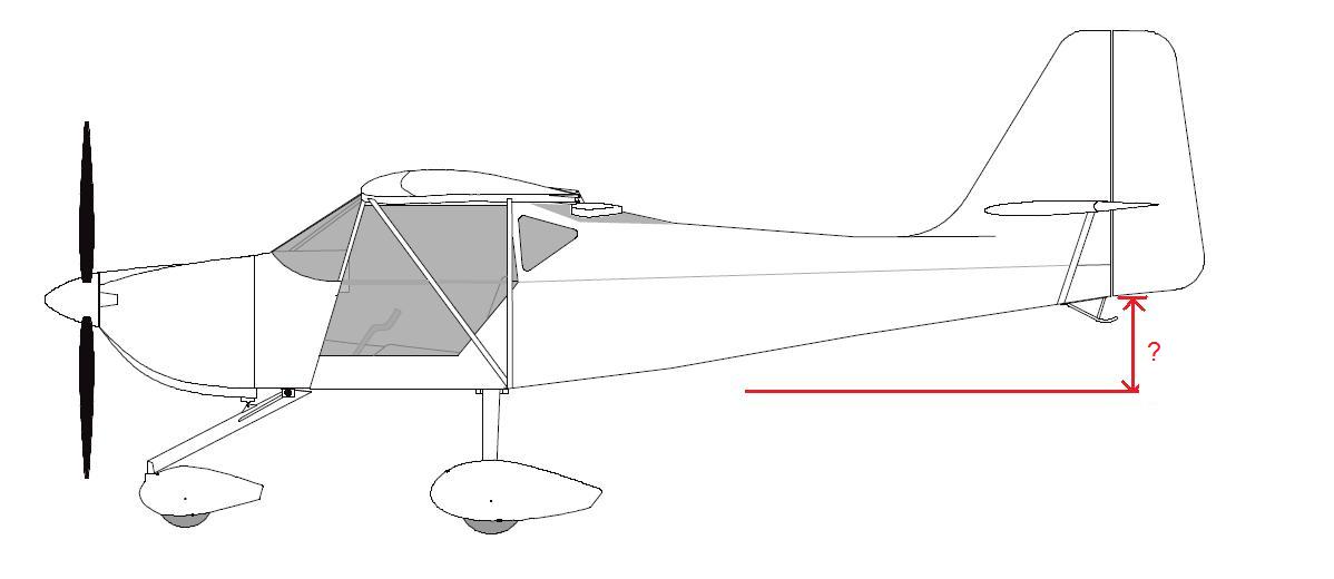

I'll be receiving my kit soon and want to build saw horses to keep the fuse level. What is the height from the bottom of the cabin to the bottom of the tail?

Jorge, do you know any measurements from the fuselage that you can use to establish a scale for the drawing you posted and measure from that. when I was building I built one high saw horse and just slid it foreward from the tail until the fuselage was level.

I think it is about 17 1/2 in. on mine.
