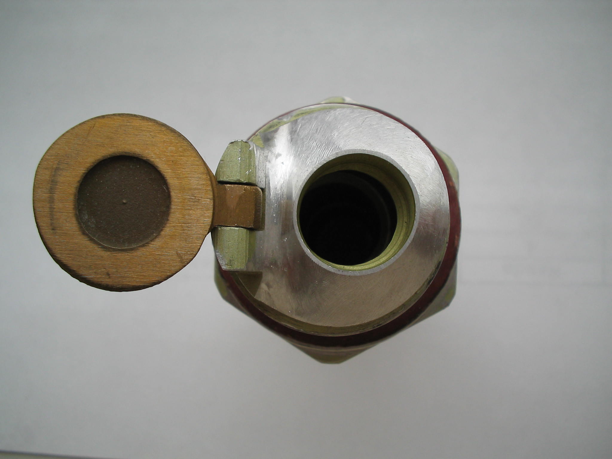

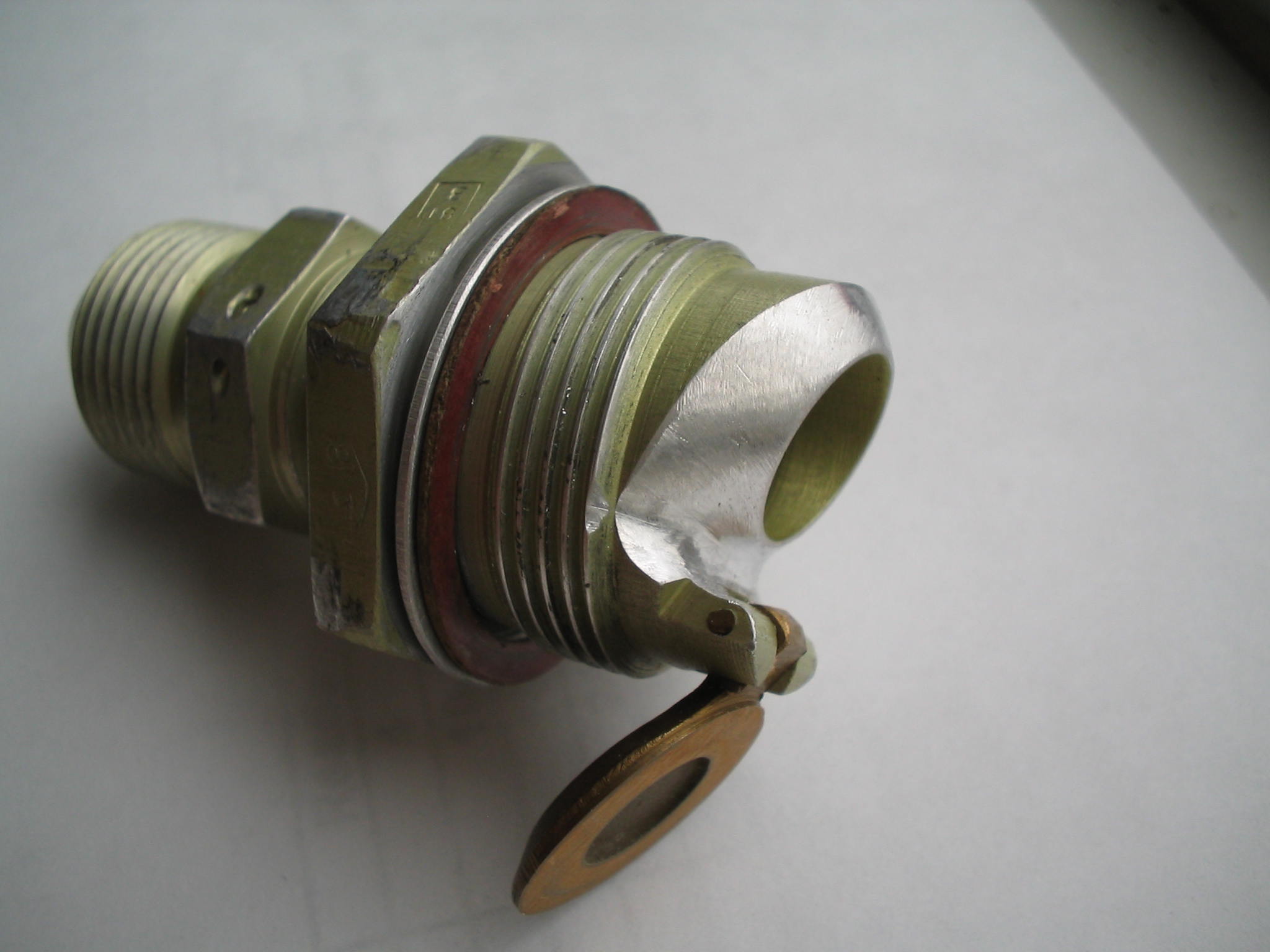

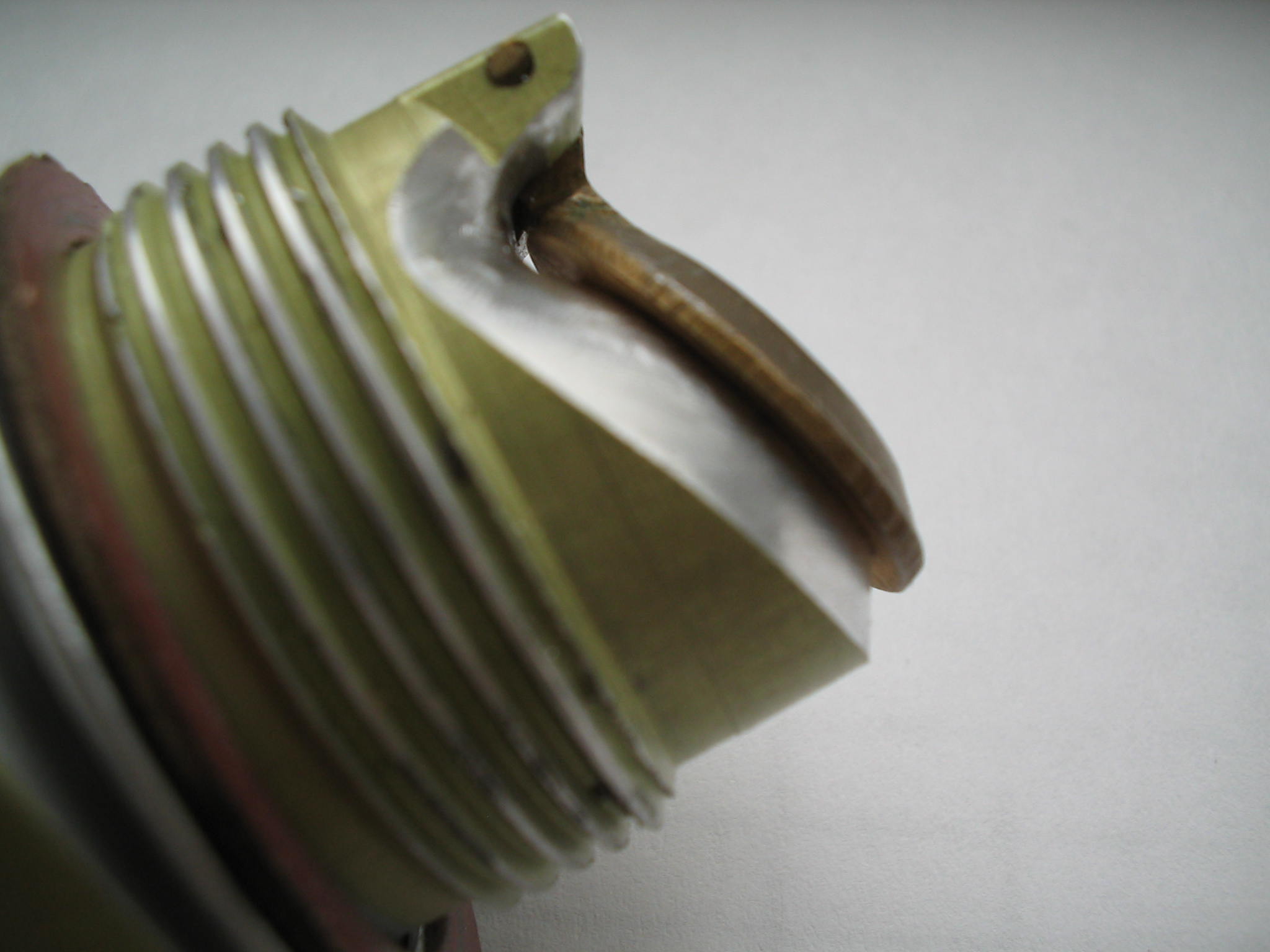

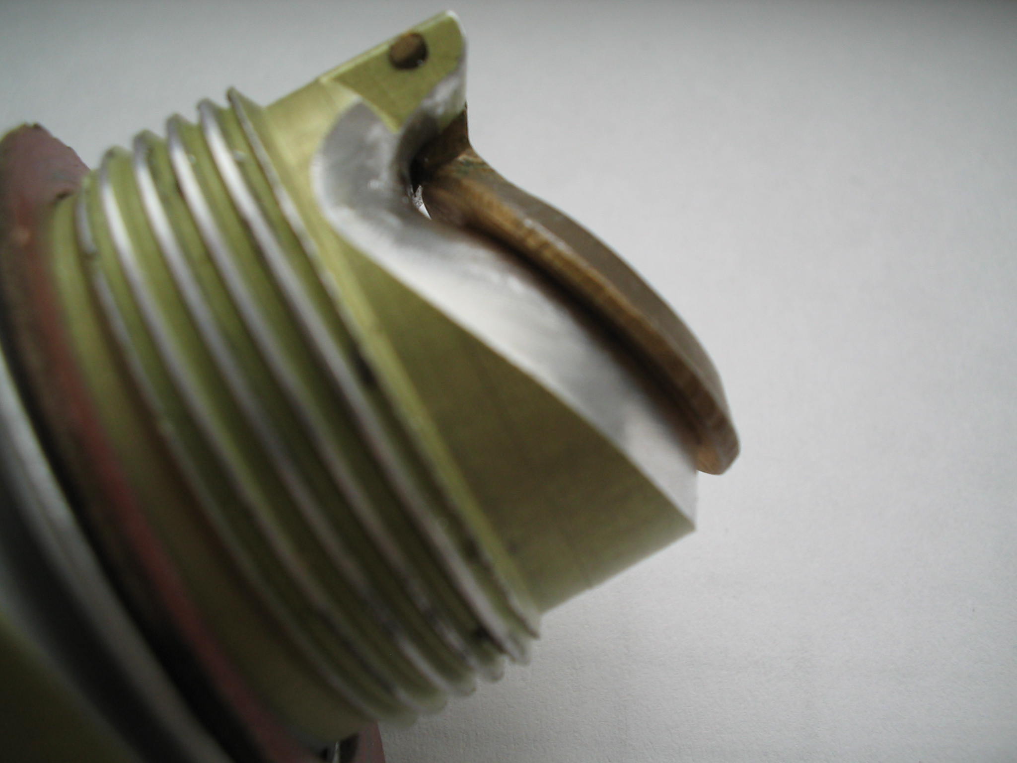

wlannon(at)persona.ca
PostPosted: Tue Mar 25, 2008 8:35 pm    Post subject: CJ Aux FuelCJ Aux Fuel Reply with quote
 Filesize:  160.9 KB
 Viewed:  461 Time(s)
 Filesize:  177.88 KB
 Viewed:  460 Time(s)
 Filesize:  171.55 KB
 Viewed:  438 Time(s)
PostPosted: Tue Mar 25, 2008 8:49 pm    Post subject: CJ Aux FuelCJ Aux Fuel Reply with quote
Correction to my last post. Did the proof reading AFTER I hit send --Again!
Referred, at least twice, to the Header tank non-return check valve as a vent valve. It is not.
Walt

PostPosted: Wed Mar 26, 2008 4:53 am    Post subject: CJ Aux FuelCJ Aux Fuel Reply with quote
In a message dated 3/26/2008 12:38:06 A.M. Eastern Daylight Time, wlannon(at)persona.ca writes:
Walt,
To me this observation makes sense. My CJ- is a 69.
Do you recollect what years you might have seen the "improved" ones on?
It looks like you did a nice grinding job. How did you do it?
This has always been a little annoying and usually the only thing that spoils a perfect flight.
JIm "Pappy" Goosby
PostPosted: Wed Mar 26, 2008 8:03 am    Post subject: CJ Aux FuelCJ Aux Fuel Reply with quote
Jim;
69 and previous have the original valve.
The only later one I have seen was via photo from Richard Broome in South Africa. Richard what year is your CJ??
Thanks. Hand file.
Cheers;
Walt
