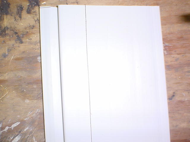

There are many approaches to the routing of the wiring and brake lines.
For the wires I have seen conduit in the center console and also wiring under both top longerons. With wires under the longerons one question is how to get the wires past 6B16-3 (left and right), the sloping braces at the outside of the seatbacks. Some route the wires around these parts in flexible conduit while others drill holes in the parts.
One solution for the brake lines is to enclose the channel on the bottom of the plane. Ed Moody posted a series of photos of this solution last September.

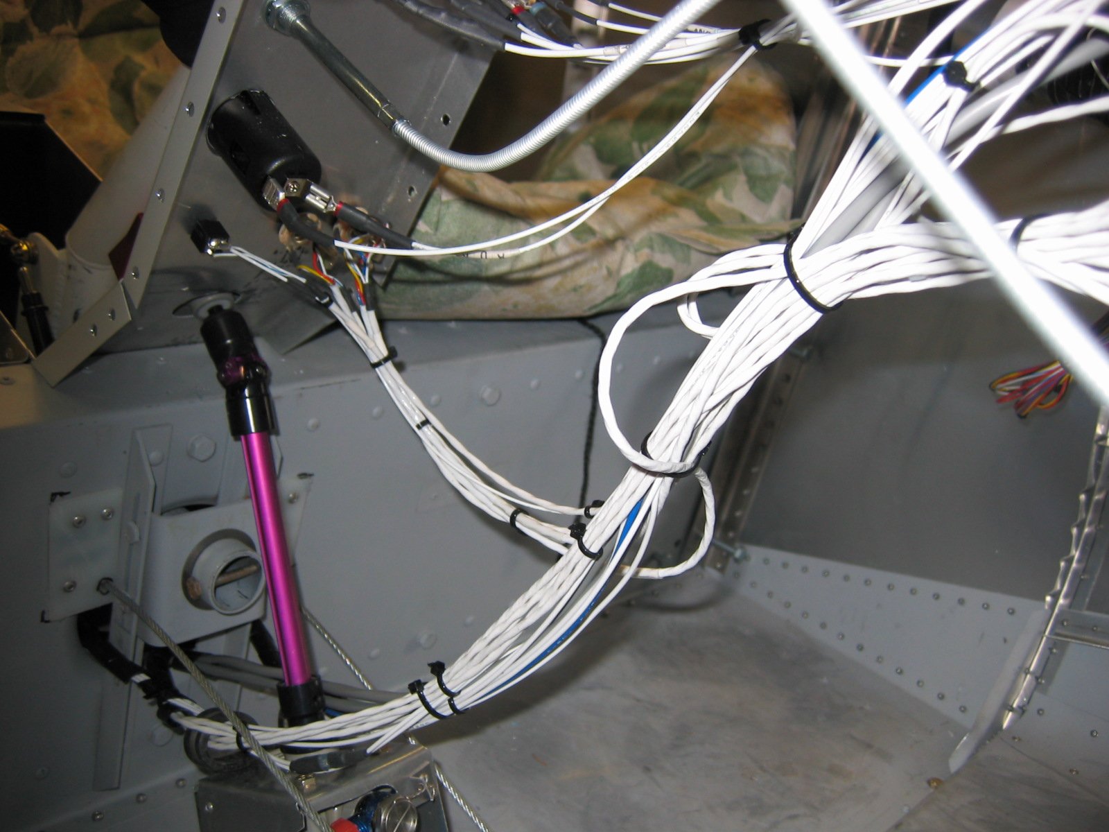

You asked some good questions that have been asked before. Search the archives where there has been a lot of discussion on each of the topics. I will give you my opinion and what I did. I am not flying yet so it is all still theory and subject to change given real world results.
1. You can get wiring from the rear to the panel via three routes. Left armrail, right armrail and through the middle spar opening and center console. I used all three. I kept power items in the center and left the armrails for antennas. I attached a picture of the stuff going through the center spar.
2. I used adel clamps screwed to the rear of the gear leg. The ZAC demo plane used stick-on tabs and some of these have lifted off. I asked ZAC about routing out a channel down the rear of the gear leg to imbed the bake line and they advised against this. See picture attached for what I did.
3. Brake line routing. ZAC says to route through the middle spar opening and out the side skins at the gear leg. I did not think I would have enough room there so I ran them below the cockpit floor and back along the fuselage bottom. Now that I have done this, I don't like the looks of it and may change back. Again, see picture attached.

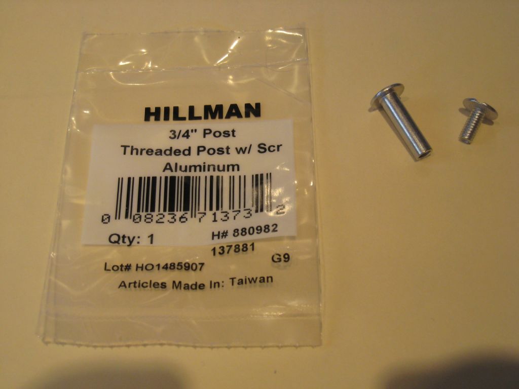

One "pretty" way to run the brake lines down the rear of the gear is shown
in the attached pictures. I don't know what the proper name for the special
"threaded post" nut and bolt shown is. Mine came from Lowes.

They are called Chicago screws, I don't know why, Dan.

Believe it or not, they are called "sex bolts".......Really.

You can also google “binder posts”. Apparently one of their intended purposes is to hold together stacks of three-hole punched paper without a three ring binder.

The brake lines can be streamlined and nicely hidden beneath a piece of
vinyl gutter guard that is cut down and attached
with Gorrilla Glue to the rear of the gear legs providing a nice channel to
run the lines.
If the attached pic does not come thru check this site
http://picasaweb.google.com/Papawobo
Gary Ray 601XL, WW Corvair (0.020 over), 68 hr tt
davgray(at)sbcglobal.net
