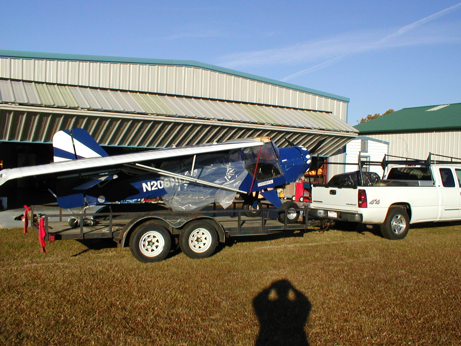

PostPosted: Mon Apr 07, 2008 3:47 am    Post subject: Draining Wing Tanks Reply with quote
Pete,

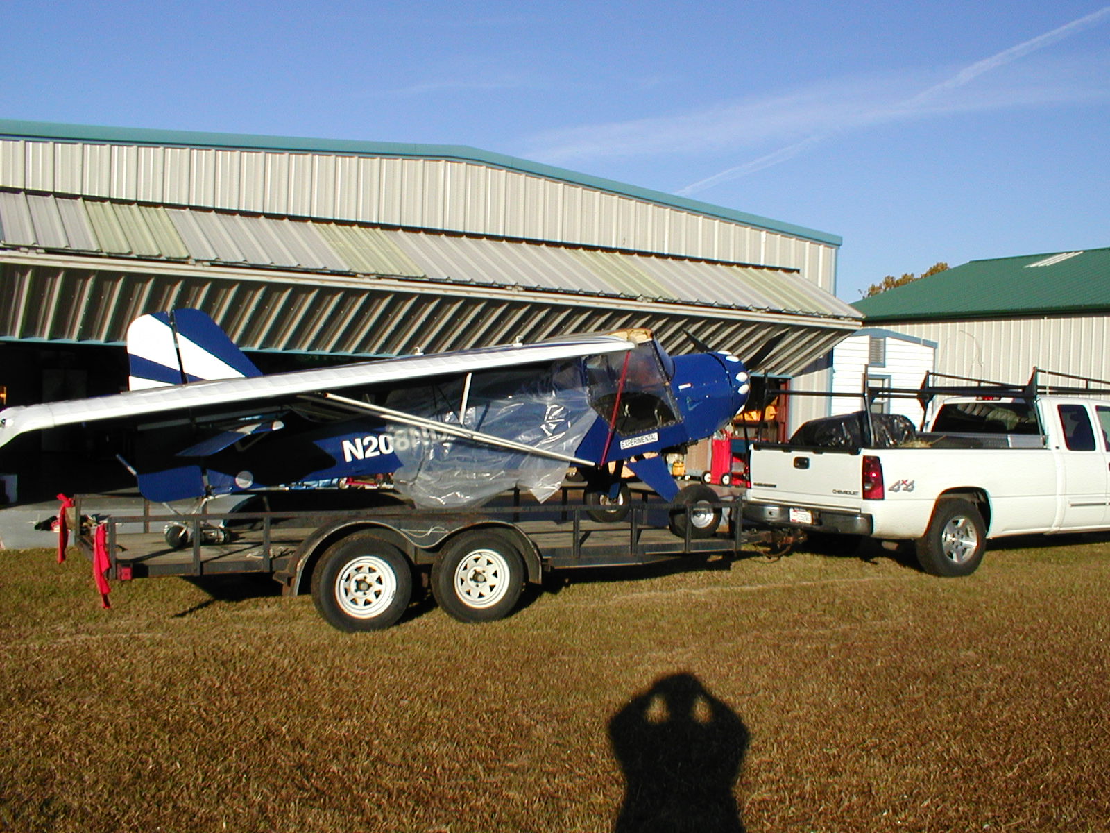

I trailered my Kitfox from Mass to Fl on a flatbed trailer. It was also on the trailer with the nose forward and tied well. The tail was supported just forward of the tailspring with a hay bale (removed in picture)to keep the aluminum spring off the deck and possible breakage (I no longer have that spring but have a nice 3 leaf steel I bought from John McBean)  The tanks were drained to reduce weight and it traveled well at over 70mph for aprox 2200 miles. The only "damage" was a lot of road salt I had to clean off and scuffing on the tires. Apparently the bouncing slowly rotated the tires up against the trailer rails and put scuff marks in the tires.
Truckers on the CB commented the plane looked like a large beetle!

PostPosted: Mon Apr 07, 2008 7:15 am    Post subject: Draining Wing Tanks Reply with quote
Dick, How do you support the wingtips. You can't leave all of the weight on the rear wing attachment pins with the leverage of a 14' long wing. The bouncing of the wing, even without gas, would bend or break something I am sure.
do not archieve

Lynn Matteson
Posts: 2778

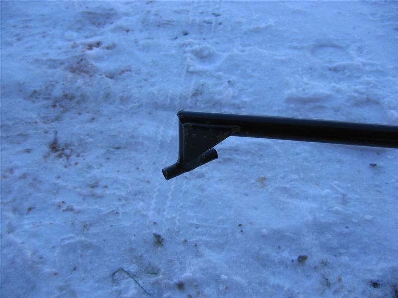

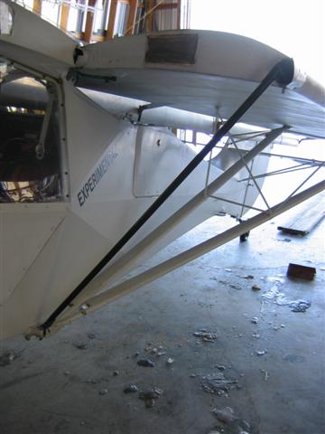

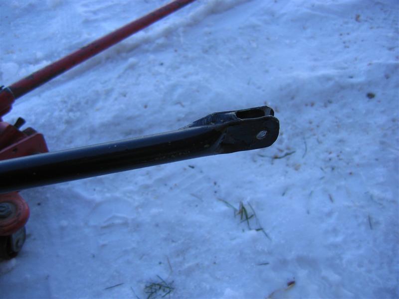

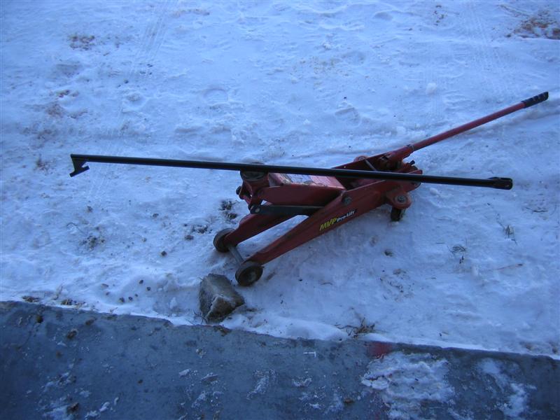

PostPosted: Mon Apr 07, 2008 10:14 am    Post subject: Draining Wing Tanks Reply with quote
With the wings swung back, most of the weight is still carried by the
lift struts, but you still have to support the outer portion of the
wing with wing braces that go from the front spar attachment point to
the float bracket just in front of the strut attachment point. The
wings are held from swinging outward by a couple of braces that go
from a point near the rear strut-to-wing attachment to a tab sticking
out from the fuselage near the horizontal stab.
A recent poster (Keith C.) just completed a 1700 mile trip using this
method, with no problems. John McBean probably sells everything needed.

PostPosted: Mon Apr 07, 2008 12:19 pm    Post subject: Draining Wing Tanks Reply with quote
Lynn, I saw a Kitfox with tubular braces from the bracket that the wing struts, and I guess the float gear attach to, to the leading edge spar as you mention. It just doesn't look like that would support the wing enough. It looks like the weight of the wing bouncing in transit would use those support points that are close to the inner end of the wing to act as a pivot point applying large torque force at the rear wing attach pin.
Pat Reilly

we say in Texas. Towed it backwards and it fit perfectly. Towed about 60
miles only 10 of that on interstate.

PostPosted: Mon Apr 07, 2008 6:53 pm    Post subject: Draining Wing Tanks Reply with quote
Here are a few pictures of my wing supports that came with my MK IV from the factory. They seem to work just fine. Jim Chuk Avids Mn
Lynn Matteson
Grass Lake, Michigan
flying w/487+ hrs/down for annual

I see what you're saying, Pat, but in use they work just fine. At
least the ones I built work fine, but I have the shorter wing...less
moment to deal with...and made sure to have no fuel on board when I
trailered mine for the approx. 60 miles that I actually used them. I
loaned Keith mine for his 1700-mile trip and he reports that they
worked great. Now I got the preface this with a disclaimer....I built
mine with approx 1/8" wall thickness steel tubing, not the electrical
tubing that I read someone was using, with a bent end for attachment.
I think the real trick is to get the fuel out, and stay off really
rough roads.

PostPosted: Tue Apr 08, 2008 4:43 am    Post subject: Draining Wing Tanks Reply with quote
Lynn and All,
Interstate 5 in Calif. was no picnic, rough wise, and everything still seems
OK. The braces I had made are from square steel tubing? They are patterned
after Lynn's and I like the security of them being that solid. If you
notice the little bit of lift needed to replace the wing and pin it, that
weight needs to be supported by the brace while bouncing along the road. I
now would not move it without the braces in place.
