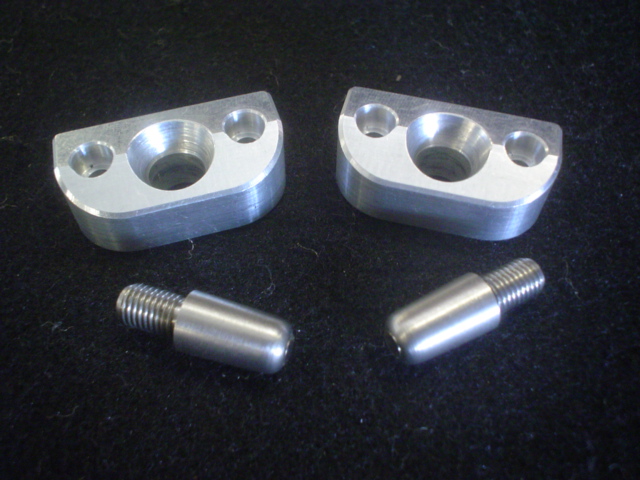

As far as the taper IN or taper OUT, I'm sure that their
reasoning is that a taper on the outside will tend to
suck the door in to alignment as the pin goes into
the door post. From a ping engagement length stanpoint,
this gives perhaps a little less pin length to hold the door
all the way in, but the pin should have a lot of
travel to it. It may ideally be that you don't want to
make that taper quite as long.
The pin should engage plenty, so that there's quite a
bit of pin on the back side of that metal door post.
Lest people think that this is a problem with the nylon
blocks, it's not. Those shouldn't be part of what holds
the door shut...they're just there as a guide. The
pin is held by the metal door frame, so not even
the fiberglass should matter much in keeping the door
latched. This is NOT to say that you wouldn't be
better off with the rivethead door latch pins. I don't
have them, but I see that there are some good benefits
to having them. Anything you can do to make it better
is good.
Now, on a pin adequacy as built per-plans, I really
feel that if someone has problems of this sort, and they
built the latches with the proper pin length and engagement,
then the fault is squarely on the pilot. This sort of
accident, with a properly built door/latch, that is
properly secured, just would not happen. Someone has
to screw up somewhere, to have an incident. This is
one reason why door latches without some form of positive
latching mechanism shouldn't be considered at all. The
standard van's inside handles, although ugly, are actually
very functional and provide a great positive latch.
I actually have to make sure to instruct the passenger
how to release pressure by pushing the handle down a bit
so they can squeeze the thumb button. It is very
solid, and just won't move a bit in flight. No,
vibration won't cause it to move, and there is no
way vibration and airframe flexing will release those pins.
It has to have a screwup on the pilots part, or an
improperly cut pin length, or a broken pin, or something
of that nature.
Should a secondary latching mechanism be used? Perhaps.
Again, if you can do something to improve it, just like
the rivethead pins, then it might not be a bad idea.
But, you're going to need to do something that will
latch on the forward are of the door bottom...so that
the front of the door can't come out and catch the
200mph breeze. Straps just won't cut it. A solid
mechanical latch would, perhaps. Is it needed? Well,
it might be a good idea, but again, if you have all the
pins latched right and built it well, you shouldn't have
a big problem the way it is per-plans either. If
someone comes up with a great kit of parts to do such
a nice latch, with drawings on how to install them, and
especially if you can do it as a retrofit on a flying
plane, then I think they could be successful selling
them.
I took 4 flights this weekend and gave rides to a few
various people. On every flight, I personally was
the one to latch the door(s)...both of them. I was
also the one to inspect the pin engagement. You can
even put your fingers on the pin tips on the back pins.
Considering that the pins are latched, and in place
properly, and built properly, I don't live in fear that
my doors are going to fly off. I'm awaiting someone
else putting the rivethead system on AFTER having
completed their doors, and if it goes well for them
I'm considering adding them to mine. The one worry I
have is that I don't particularly like only having the
tips of the pins be nice and solid on those. It would
be nice to have 6 or more inches of tough pin, bonded
in permanently with threads and loctite, so you never
have to worry about the pin tips letting loose.
Still, it seems like it's a great solution that adds
some security.

I added the pins after I had completed my door. Worked fine. I rechecked
them this weekend after hearing about the mid air door departure and the
adjustment looked fine. Per design the pins do not go all the way into the
frame, they only go to the edge so that when they are extended they do not
hit the side of the air frame only the metal block. In normal opening and
closing I have not had the back pin go outside the guide, but I do have to
"help" the passenger door sometimes to get rear pin the hole, otherwise it
will just hit the edge of the block.
Rene' Felker

Posted: Tue Apr 08, 2008 11:58 pm Post subject: The King has no Clothes |
When I went to install a set in my rv10, I modified them to be much easier
to install. After seeing my mods coupled with the shipping delays I was
asked to reproduce a similar product by a few builders. I think they are a
very good anchor for the door rods to latch into, and should add a margin of
strength to the latch mech. I do offer them on my website (available
immediately sorry for the commercial announcement, I just want all to
know there are options...
Steve dinieri
Iflyrv10.com
[quote] --

roadmaps
Joined: 08 Nov 2007 Posts: 49
Posted: Wed Apr 09, 2008 4:16 am Post subject: The King has no Clothes |
Steve,
How much for a set?
John Testement
jwt(at)roadmapscoaching.com
40321
Richmond, VA
Painting
| - The Matronics RV10-List Email Forum - | | Use the List Feature Navigator to browse the many List utilities available such as the Email Subscriptions page, Archive Search & Download, 7-Day Browse, Chat, FAQ, Photoshare, and much more:
Back to top |
capsteve
Joined: 09 Jan 2006 Posts: 111 Location: NIAGARA FALLS NY
Posted: Wed Apr 09, 2008 7:58 am Post subject: The King has no Clothes |
John,
99 gets you parts for both doors, aluminum sockets, stainless pins
with magnets, 10-32 stainless allen-screws and platenuts. Includes priority
shipping (3 day) usps.
Thanks steve

scottmschmidt(at)yahoo.co Guest
Posted: Wed Apr 09, 2008 1:59 pm Post subject: The King has no Clothes |
I have ordered the Rivethead door pins and I'm looking forward to installing them.
Is anyone concerned about cutting the door rod and having a weak point where it threads in?
Does anyone have any concerns about the system being less robust than the standard rods?
Scott Schmidt
scottmschmidt(at)yahoo.com
Back to top |
Tim Olson
Joined: 25 Jan 2007 Posts: 2881
Posted: Wed Apr 09, 2008 2:23 pm Post subject: The King has no Clothes |
That was my concern as well. I really would like to do it but
it would be nice to get the pins in hand so you can see exactly
where the threaded connection is. I'd really prefer to have 4 or
6 inches of pin before the threaded area, because I don't want
to tap my pins, and then have that junction crack, the pin to
fall out of the main rod, and then have the door come off.
With enough pin both inside the door and inside the frame though
that is one solid piece, I'd have no worry.
Scott Schmidt wrote:
[quote] I have ordered the Rivethead door pins and I'm looking forward to
installing them.
the standard rods?
Scott Schmidt

rene(at)felker.com Guest
Posted: Wed Apr 09, 2008 2:39 pm Post subject: The King has no Clothes |
My general comment would be no, I do not have any concerns. The end of the rod was already threaded per plans and all I did was fill them. ( Not exactly since I cut and threaded the rods again to shorten them.) But, they are not real tight. After 25 flight hours and the web traffic from last week, I inspected them and did not see any signs of wear. I rechecked their alignment and put some locktite on the threads. I installed mine per the video and thus they do not extend all the way into the cabin frame, only into the block itself. I am re-thinking that………..
Also, when you install the blocks there is very little room between the AL blocks and the nylon blocks in the door. I had to cut down the blocks on the door just to get the door to close. I think this closer tolerance helps to reduce the stress on the rod itself.
Rene' Felker

I am concerned about it. Not sure how to fix it though.
installing them.
the standard rods?
