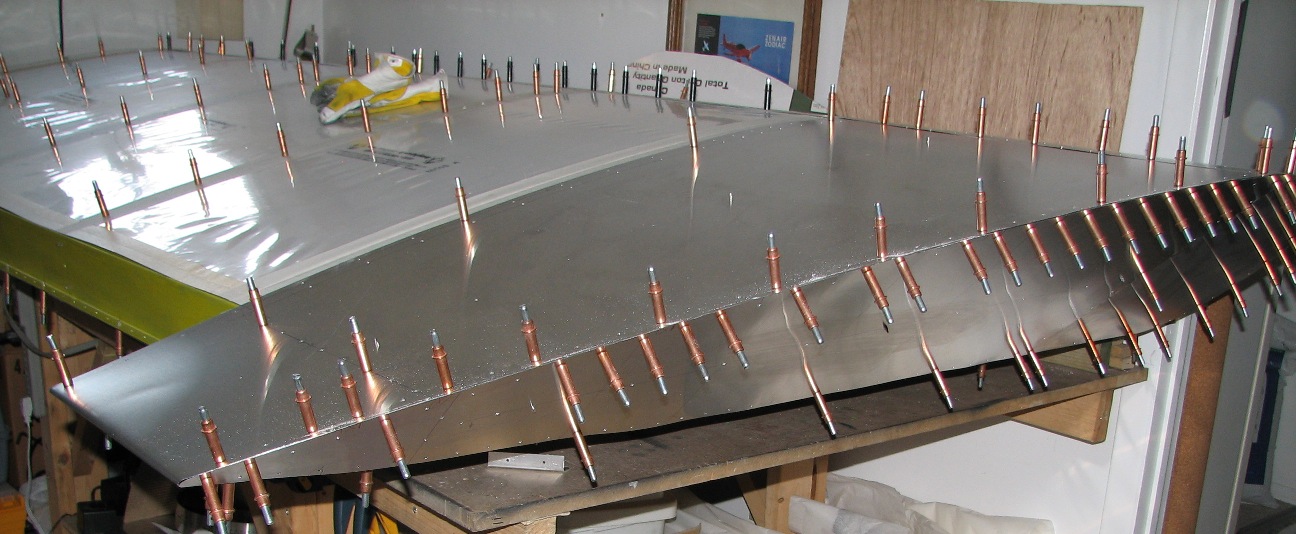

Progress report:
Last year wasn't good for my project: too much work and traveling, leaving little time for building.
Thankfully, things slowed down the past few weeks, and I was able to complete the right wing panel (complete as much as we can in Canada, as it needs to be inspected before final closing).
(See attached picture (1.06 MB) )
Polishing skins for the left wing has started (2.2 sqft / h).

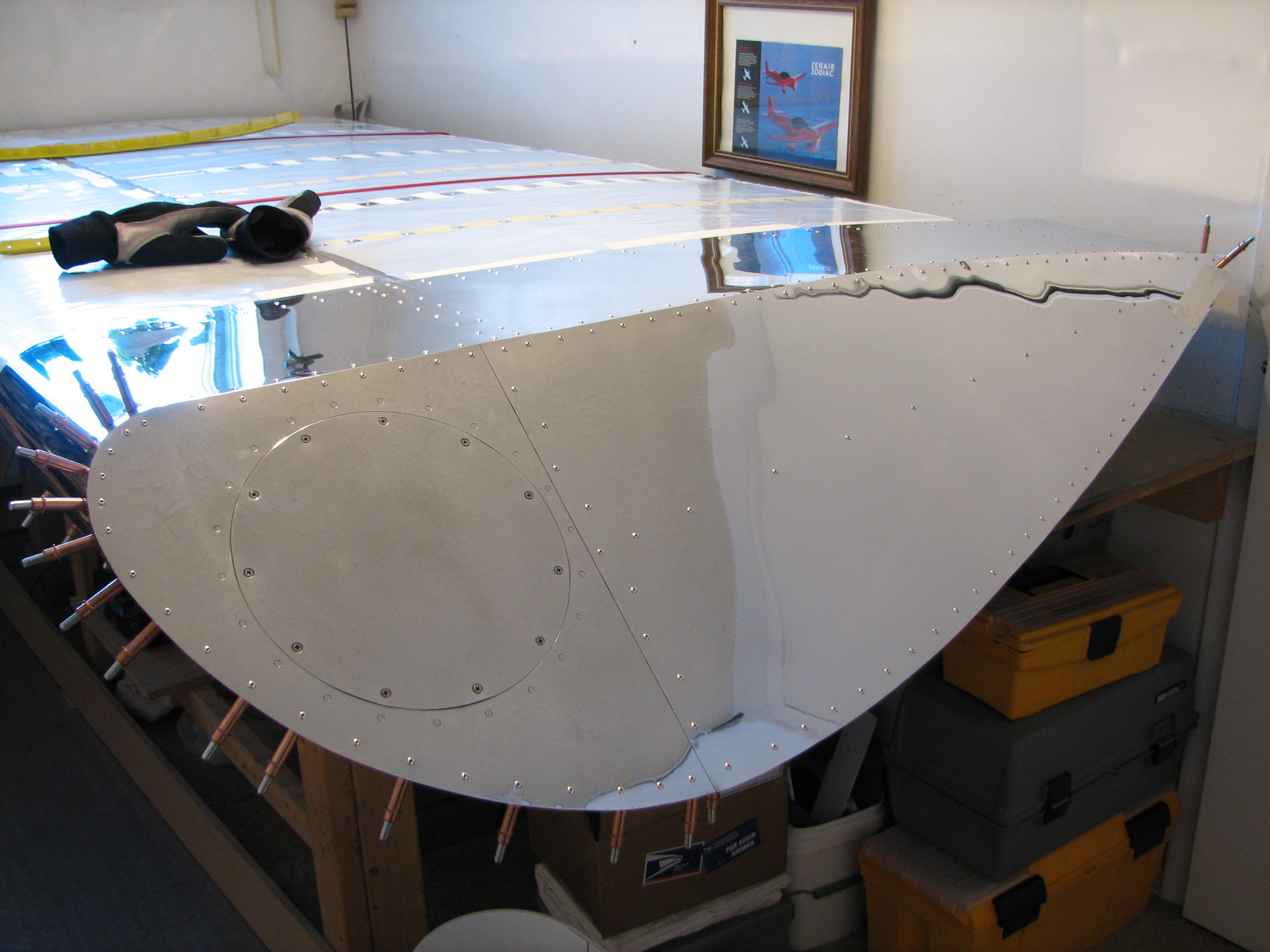

(1) The all-metal wing tip is not in the plans (HD/HDS or XL) - but it is fairly easy to make. And I don't think it would be much different for the XL.
If anyone want details, let me know.

No. I'm with you. I thought the same thing. But you would lose the effect of the Horner tip. What would be really cool would be to shape an aluminum horner tip.

Kevin, the Horner tip is still there. See attached picture - a bit older, before polishing and riveting.

I stand corrected. I guess I misunderstood what a horner tip was
exactly. I've read CH's description of it, but thought that the
fiberglass tip was more concave than it actually is. I see that now. I
am plans building, and haven't made the wingtips yet, so I do not have
an example to hold in my hands. Thanks for setting me straight.

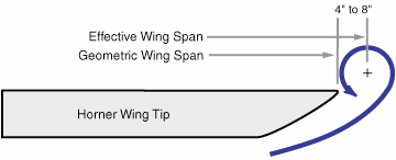

The horner tip is not the swooped (good word Smile ) front part , it is the angle.
20 lbs of paint is a big deal I think it may be more on really cool (metallic and clear coat) paint jobs.
Ask around to find out how many 701s come in at 580 or even 600 lbs. Instruments/avionics and paint are your biggies apart from engine choices.
 Filesize:  3.77 KB
 Viewed:  22490 Time(s)

Part of the effectiveness of the Hoerner (not Horner) tip can be attributed to that rounded nose part. It is a part of the whole enchilada.

???? both spellings and pic from:
http://www.zenithair.com/stolch801/design/design.html
