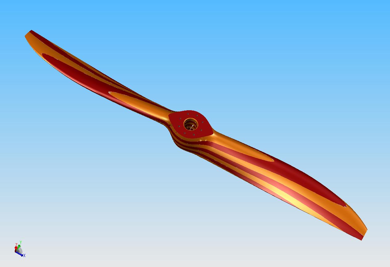

attached a reason for wood prop.

Thanks Jan... Very in depth, however, your idea that each blade at 40 inches

I agree with your reason for a wood prop.
Beautiful craftsmanship!

I don't think composite props handle the vibration as well as wood.
In the early days of the Corvette, with our notoriously bad roads, the
bodies of the cars cracked profusely and were always undergoing repair.
Since then there have been many advancements in composite construction but I
think it just doesn't stand up to vibration as well as natural wood. Wood
on the other hand won't age nearly as well as composite.
Neither prop should be flown through rain.
