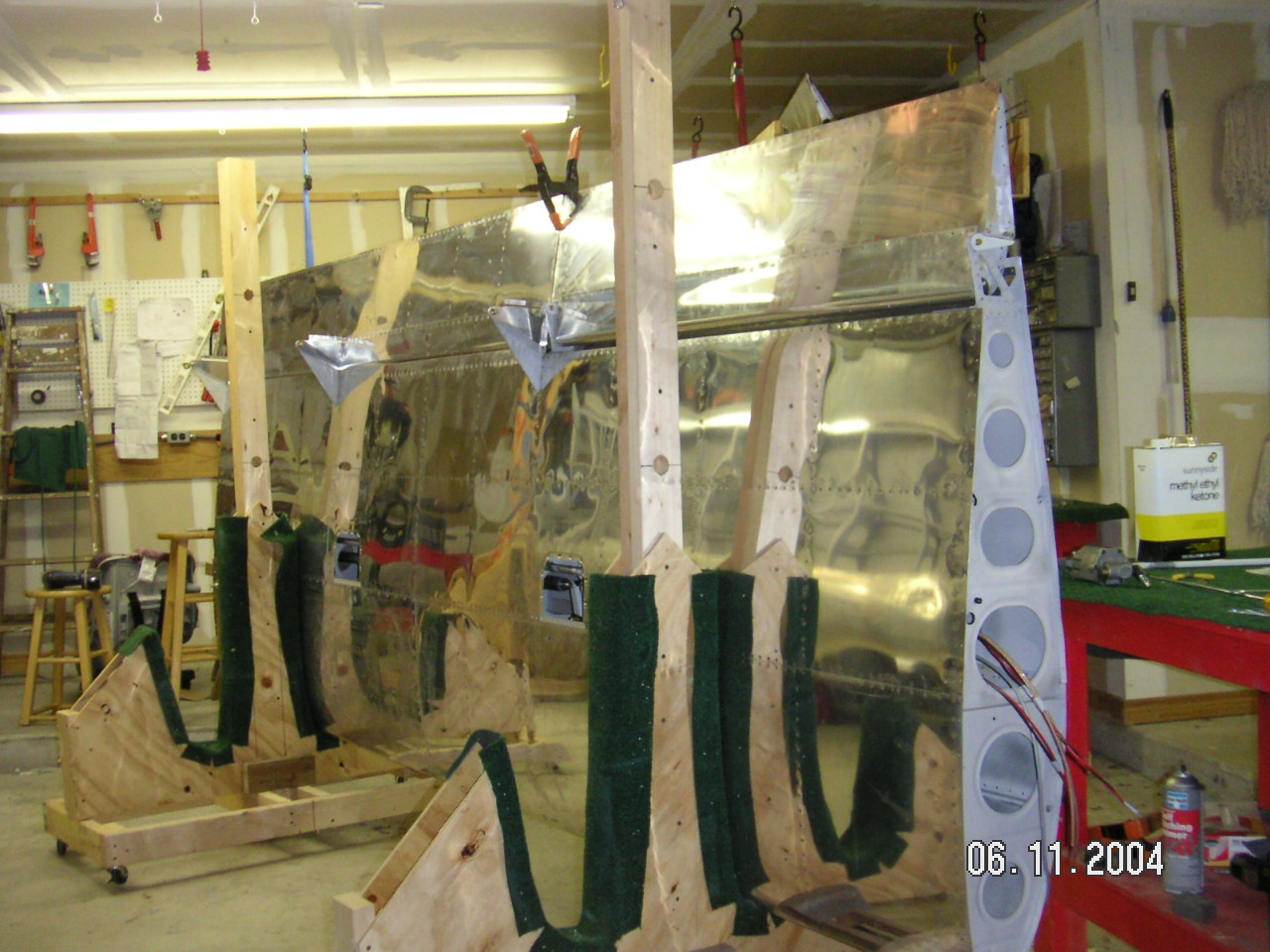

Does anyone have pictures or plans for making a wing rotisserie? I
want to be able to rotate the wings while they are being painted.
Also, any suggestions for the size and plans for a homemade paint
booth would be appreciated.

Bobbie sent me the file to post since it was a little big for
the email list. Here's a link:
Http://www.MyRV10.com/tips/paint/Wing_Stands.pdf
I'll get it worked into the regular tips area soon, but at
least for now you all have a place to download it.

Posted: Wed Apr 16, 2008 5:47 am Post subject: wing rotisserie & paint booth |
The rotisserie wing stands where used to build my wings. I could
offset, rotate the wings vertical and slide them to the side of my
garage. My wife was then able to park in the garage and life was good.
There may be a better method and this may be overkill for painting. I
also used one pair of stands as wing cradles for storage and moving the
wings to the airport. Just cut the wing rib pattern in the plywood
bracing and cover with carpet.
