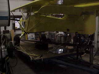

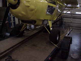

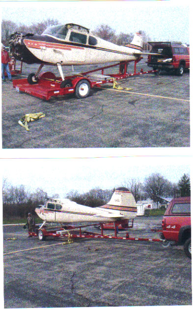

Remember Guys,when I asked every one for ideas for a TRAILER??this past
winter?I took all of your ideas+mine.I drew my own plans what I thought
a trailer should be.and here is the finished idea..I had it built by a
Trailer company called Weld Tech..This is the first time that I had a
airplane on it,on a 100 mile trip.right down I-75.at 60-65mph with no
problems..This will haul all most any single engine airplane TW or tri
gear airplane..and it will fit in a 1 car garage..this plane is a 1948
C170.4 place airplane.tri gear planes fit on the orther way,nose wheel
sits in the V nose of the trailer..airplanes all sit close to the
ground,,all so trailer has wing racks on each side for up right
hauling,tri gear main landing gear sits on out riggers attched to the
trailer that pulls out in the V part of trailer on the out side of the
frame.I can haul any single airplane up to app 2500 lbs.I have showed
this to a few people and airplane haulers.and they are interested in
buying them.I have one sold all ready so far..NOW I want more help from
all of you what do you think of this set up??will it sell???do you think
there is a market??I have sold 1 all ready,and the trailer company is
building the next on for me.this will be trailer no 3..this trailer here
that you see is no.1,,and is the pro type trailer or demo trailer..I
want to have a web site set up to market these..any ideas???think it
will work??? THANKS Kitfox family for all your ideas for this
trailer....STEVE SHINABERY N554KF + KF2 ,,P.S.all so this trailer
will be on display at the GREAT LAKES AREA KITFOX FLY-IN Sunday May
11th at Celina Oh..{CQA}west central Ohio,,oh yes the trailer has 2
different toungs all so a short + long one.and all so has a winch..along
letter you are all board probley now..just wanted to see what every one
thinks of it...

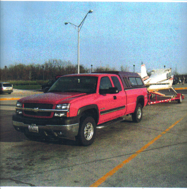

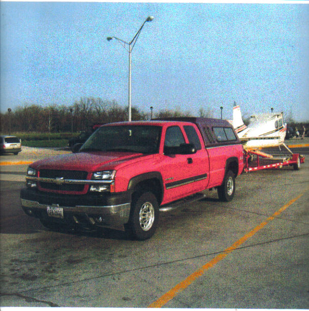

PostPosted: Tue Apr 22, 2008 9:48 pm    Post subject: Trailer Reply with quote
another picture of trailer at a road side rest area north of Cincinnati
Ohio on I75 heading home to Lake field airport.handles great.but be care
full not to run over the mail box across the road from my home on the
way out ,to pick this up :-[ it is extra long,,,STEVE SHINABERY N554KF KF2

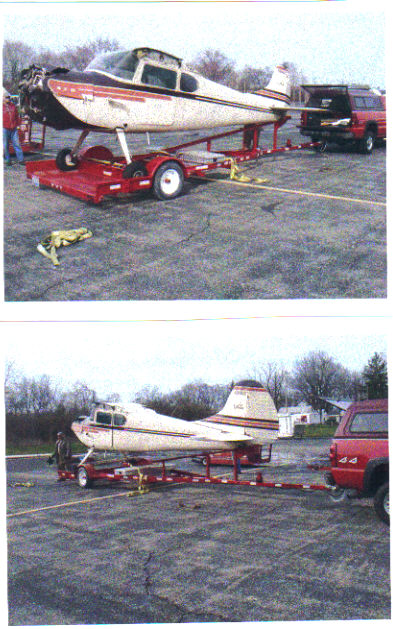

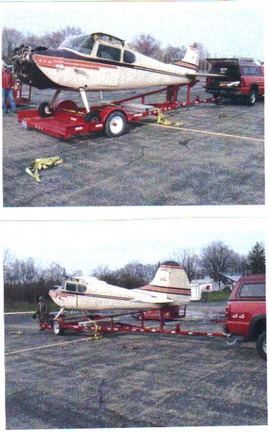

Looks similar to what I built.
John Hart
KF IV
Wilburton. ok

Nice trailer. As for the viability from a business perspective, I think much depends on your expectations. Would you be happy if you sold ten in a year? With general aviation being a shrinking industry, I think that number would be more likely than 100. For what it's worth, here's what I would do:
First, use the money from your first sale and buy a MIG welder and a chop saw then take a welding class. Building your own trailers will maximize your profit and you get to learn something.
Second, rather than building a particular trailer and then trying to sell it, I'd approach the business as more of a "custom aviation trailer" shop. That way, you can tweak your trailers to the unique needs of each customer. I for one would rather have a trailer that is built specifically for my Kitfox with a suspension tuned for my airplane's weight rather than a 'one size fits all' approach.
Hope this helps.

There may be a small market for such a trailer. A few months
ago we had a Luscombe groundloop with severe damage. The local
airport bums, (me included,) basically carried the plane off the
runway, but then it had to be disassembled for return to the pilot's
home base. (No repair facility locally.) Fortunately one of the FBO's
had this huge trailer that was designed to carry disassembled
airplanes so we loaded it and sent him off.
I would guess that every region needs some capacity for
dealing with damaged aircraft. You could market it to one of the FBOs
in the region and promise to advertise that purchase throughout the
region so people could come beg/borrow/rent it.

I think the key to the whole thing is the suspension issue. Anybody
can put together a trailer, but to be able to get the plane from A to
B without "shakedown" damage is the utmost thing that I'd worry
about, and carrying too little weight on a stiffly-suspended trailer
will kill a light plane, or at least injure it.

Maybe an adjustable air suspension or air shock absorber option?

Why not just add a couple of hundred pounds of ballast to the trailer..
visit a shop and try to make the ballast usable or at least saleable when
you get home.

Yes,and lower the tire pressure on the trailer and the plane makes
the ride nice and soft. Put a soft sponce ball under the tail of the
plane to save the back end. Woke for me for 500 miles using a 7000
pound gross car hauler.
