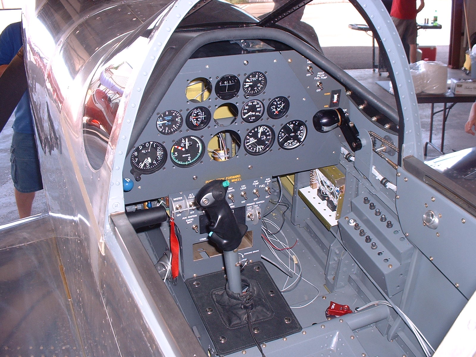

BSchroeder(at)uta.cog.ut. Guest
Posted: Fri Mar 03, 2006 10:37 am Post subject: Top skin removal |
I hope that the file isn’t too large. This is a picture of one of the Stewart mustangs and if you look just in front of the wind screen you can see the access panel. I think if there are no structural problems, I would like too have access to the back of my panel like that. I also, hate to work under a panel, when there could be a better way to do it.
