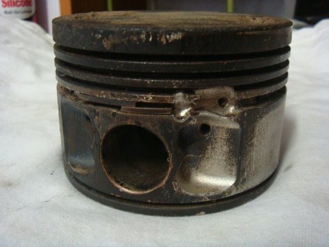

The main failures we see in the 1830/20 are thrust bearings and main bearings. Almost without fail, it usually goes "TU" soon after first power reduction. First we get a chip light, than an oil filter bypass light. Right after that we get an oil pressure drop than a oil temp rise. That is an "automatic feather" for us. Just a chip light or just a bypass light only makes us watch that engine until the flight done. We than go to the chip detector or oil filter, open them up for a look see.
"Dead cylinders" are the next most common problem. During the war, squadron level maintenance never change cylinders. They would just yank the whole engine and replace with a "QEC" which usually took just 4 hours to do. The engine was than sent back to a depot. The most they would do is change out a mag, starter, any of the pumps or generator. Many engine didn't last 100 or 200 hours. It was just the way they were operated. . Unbelievable time spent at "max continuous power" in climbs that lasted hours. Constant power changes trying to stay in formation. Plus all the imaginable climates they operated in. Starting and stopping these takes its toll. I've been told and seen written here, M14p used on ground generators and pumps will run CONTINUOUSLY for some 20,000 hours.
Jill Grenetzke has a very good article on M-14 failures in the last issue of the "Red Alert". For us pilot types it even has pictures of the different failures. BTW all RPA members automatically get the magazine which has a lot of pictures.
The picture above is of #3 piston removed my engine with 438 hours fresh purchased from Aerostar. I got a chip light and found lots of metal in the 10 micron filter. You can see that either a scraper or compression ring was put in the oil groove instead of an oil ring. The ring was broken in about 4 or 5 pieces. A compression test found the cylinder. You can see where the ends of the ring jammed over each end. Note too how the lands have broken down. This same engine now has 1300 plus hours with #3 cylinder in the mid 70's. This piston sits in a prominent spot on my hangar desk. NO I don't use as an ash tray.
Jim "Pappy" Goolsby
