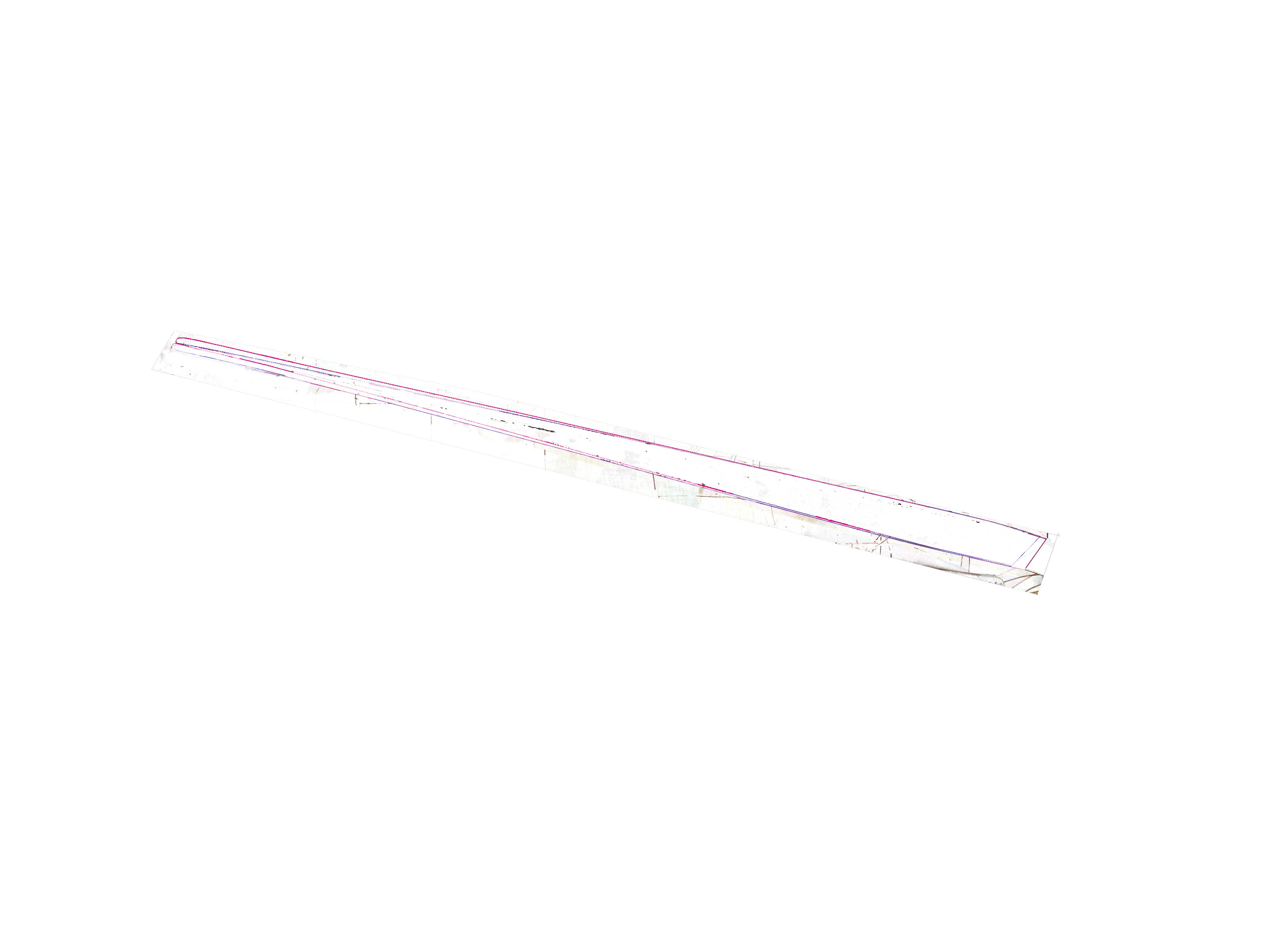

Hours were about 600. However, there has always been a vibration, an annoying feeling its not running sweetly, between 4400 and 5100 revs that has just recently increased to 5300 revs. I have pretty well followed your path trying to track it down, but without a balance have become stuck on that. I suspect my prop, and will try and change it for someone elses soon.
I took three photos from a stationary camera of each blade in the same position then outlined each blade and superimposed them. I don't know if this is a valid way of checking, but it shows one blade is certainly not on track and surprisingly for a lot of its length. Checking the tips for track is not enough perhaps. see attachment.
What is strange, if that is what the problem is, is that at 5400 revs it runs so sweetly. If the prop was the problem is that possible?
The only other clue I have is that checking the mags will give a rough patch very briefly as the revs drop, which I think could be in the float of the bearings of the gearbox. This engine was completely opened up when the sprag clutch broke, 100 hours ago.
Basically, I "share your pain" It is bloody frustrating trying to track this down as there are so many variables, and it is potentially an engine destroyer.
