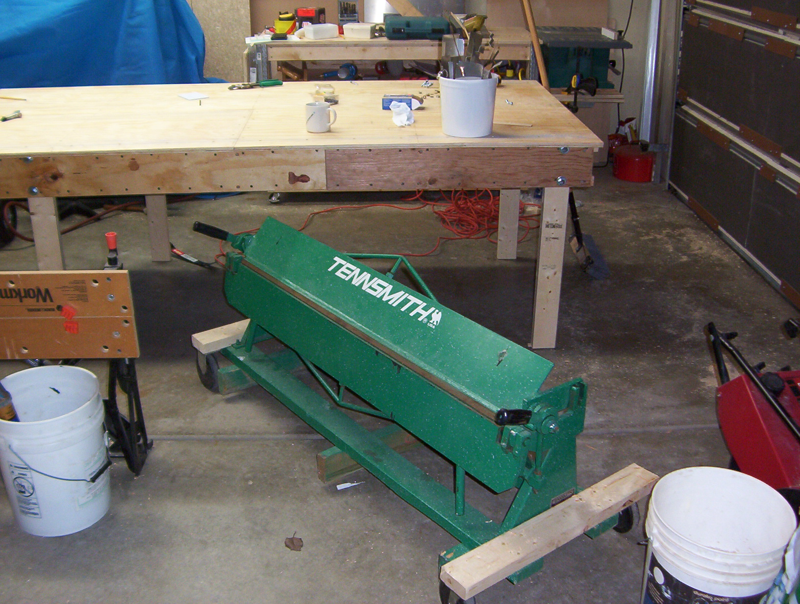

Good dialog Andy,
Here is a picture of the leaf brake I'm using. Notice the angular structure (A-frame) above and below the bending frame. These are there specifically to tune out the feature you are experiencing. There is a treaded nut at the center of the A-frame for adjustment.

PostPosted: Sun May 11, 2008 4:49 pm    Post subject: Re: Bending- again... Reply with quote
Thanks Ron. Yeah, my bending brake is of this type, with the pivots at the ends. Depending on how I adjust it (or misadjust it Smile ) I can make a stright bend, and trough bend, or a saddle bend. Just depends on the tongue and clamp adjustments. Obviously we're interested in standard straight bends though. Smile
Ron Lendon wrote:
Good dialog Andy,

That's a fine looking unit Ron. Yes I know all industrial brakes have the tensioner on them, where Dave's design uses the piano hinge to maintain even pressure, as long as you don't ask too much of it!
I may even shorten mine yet, as the 10' is probably not necessary as I first thought.

I have been following this thread, because the bending brake as well as the flanging die really had me thinking for awhile. I also have a 10 ft Daves brake ( he really should trade mark that name Wink I had a 4 ft Al brake from A.Spruce that did just what yours is doing! Crap... don't buy one! Anyway my point is, fix the problem and keep the length. Is it necessary for this airplane...nope. But your friends will know that you have one and WILL come up with all manor of things to bend. I found out that a guy I've known for years builds mud trucks!!!Of course they have sheet metal....!
