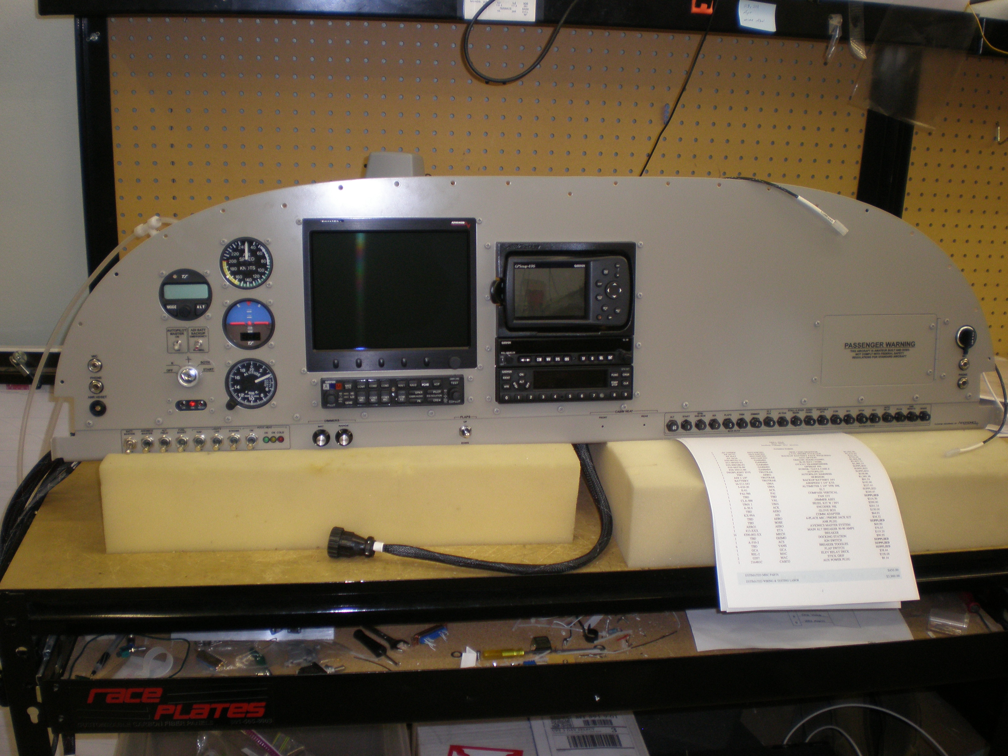

Thank you for the information Carl. I also received a call which advised me that the MB in wingtip would work with a 18"x 6" wide base plate on which the MB antenna (Comant CI-102) would be mounted as close to the bottom of the wing tip as possible. This would give me a mounting plate as well as the "ground plane". I am not that knowledgeable in this area so any help is appreciated.
I am essentially a VFR pilot but I wanted my plane certified as Day/Nite VFR/IFR so I have an SL30 Nav/Com and a Garmin 340 audio panel. My GPS is a Garmin 496. I figure that I saved about 6K on my panel over having a GNS430 plus on the 496 I get weather and Zaon traffic avoidance. Seems to me the best bang for the buck. My AFS3500 apparently displays the GS but not the MB.
Any further comments appreciated.
Panel AFS3500, GPS496, SL30, 340
