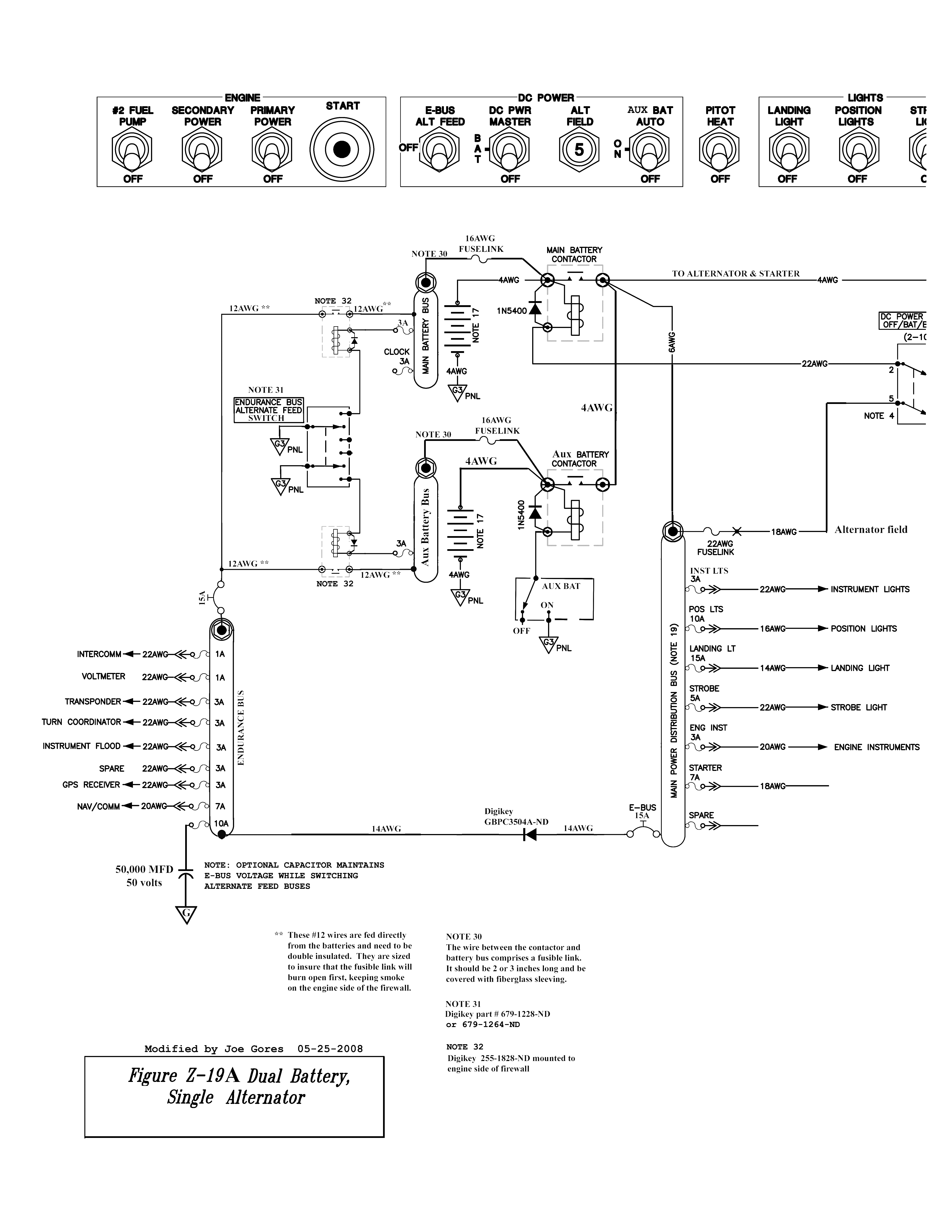

Here is a hypothetical question for you electrical gurus. A pilot is flying on trip in a plane wired according to schematic Z-19. Shortly after takeoff the main battery contactor fails open. The pilot does not notice anything wrong because the engine battery contactor is closed and the alternator is still functioning. Eventually the main battery discharges due to loads on the main battery bus, and the pilot notices some things not working. He knows there is a problem but does not know the cause. Just to be safe, he closes the Endurance-Bus Alternate-Feed switch. The question is, does the charging current blow a fuse? (either one or both fuses) The current path is from the Main Power Distribution Bus, 7A fuse, diode, Endurance Bus, Alternate-Feed switch, fuse, Main Battery Bus, to the main battery.
If the answer to the above question is yes, then everything on the Endurance Bus might not work for the remainder of the flight. I think the best solution is to increase the wire and fuse sizes in the above circuit. What size is required? Other possible solutions such as another diode or relay create additional problems.

Posted: Mon May 26, 2008 7:31 am Post subject: Hey Bob, were you referring to me as joe-pilot? LOL |
Ok, to keep me from stubbing my toe, how about the attached schematic? It features circuit breakers within reach of the pilot, dual alternate feed for the essential bus, relays to isolate power from the cockpit, one power wire between engine compartment and essential bus with fusible links to protect it.
Any suggestions, comments, or improvements are welcome.

Posted: Tue May 27, 2008 4:32 pm Post subject: Z-19 hypothetical question |
At 08:31 AM 5/26/2008 -0700, you wrote:
| Quote: |
protect it.
Joe Gores
I'm having trouble putting my arms around the rationale
for the double alternate e-bus feeds. The original design
goal for dual batteries under Z-19 was to make sure the
LAST piece of equipment on board to loose power after
alternator failure was the engine.
Further, with the double-alternate feed scheme you seem
to be worrying about double failure . . . alternator
followed by a failure of your non-engine battery to carry
e-bus loads.
For the first 25% or so of capacitor discharge, voltage
falls at the approximate rate of:
Volts/Second = Amps/Farad
Assuming a 4A bus, then 4A/.05F yields a rate of
80 volts/second. If your hoping to keep the e-bus
at say 10v or above, then starting with a fresh battery
(12.5 v) you can tolerate a drop of 2.5 volts during
transition.
At 80 volts/second decay, you can tolerate an open supply
line for 2.5/80.0 or 32 milliseconds. Hmmm . . . you
can probably get the transition over with in that time.
But suppose you're switching from a discharged battery
at 10.5 volts. Now the capacitor starts at 10.5 and
transition has to be completed in 0.5v/80vps
or 6 milliseconds.
This exercise illustrates why we don't attempt these
kinds of things in the big iron birds. Every piece
of equipment we install is qualified to make graceful
recoveries from total loss of power during switch
or relay transitions.
Let's revisit Z-19 as published and you tell us
what failure mode is not addressed.
( . . . a long habit of not thinking )
( a thing wrong, gives it a superficial )
( appearance of being right . . . )
( -Thomas Paine 1776- )
