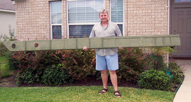

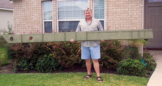

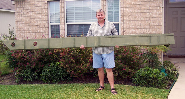

PostPosted: Sun Jun 01, 2008 10:10 am    Post subject: Re: Building Spars Reply with quote
I think quite a few folks on this list have built their spars. It's fairly time consuming, but not extremely difficult.
Dave Clay
 Filesize:  80.49 KB
 Viewed:  659 Time(s)
 Filesize:  105.98 KB
 Viewed:  666 Time(s)

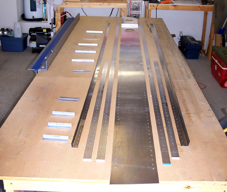

PostPosted: Sun Jun 01, 2008 10:27 am    Post subject: Building Spars Reply with quote
I built my spars from scratch, but when I ordered the .025 spar web, I
was surprised that they cut it exactly 209mm. That saved me a lot of
trimming. I managed to get the three sheets required for the ribs and the
spar webs plus a few extra pieces cut small enough to get it into my
station wagon. My spars are completely riveted and ready for ribs and
skin. The spars were not that difficult to drill and rivet, at least I
don't think so.. good luck Ron keep plugging.....Do not archive

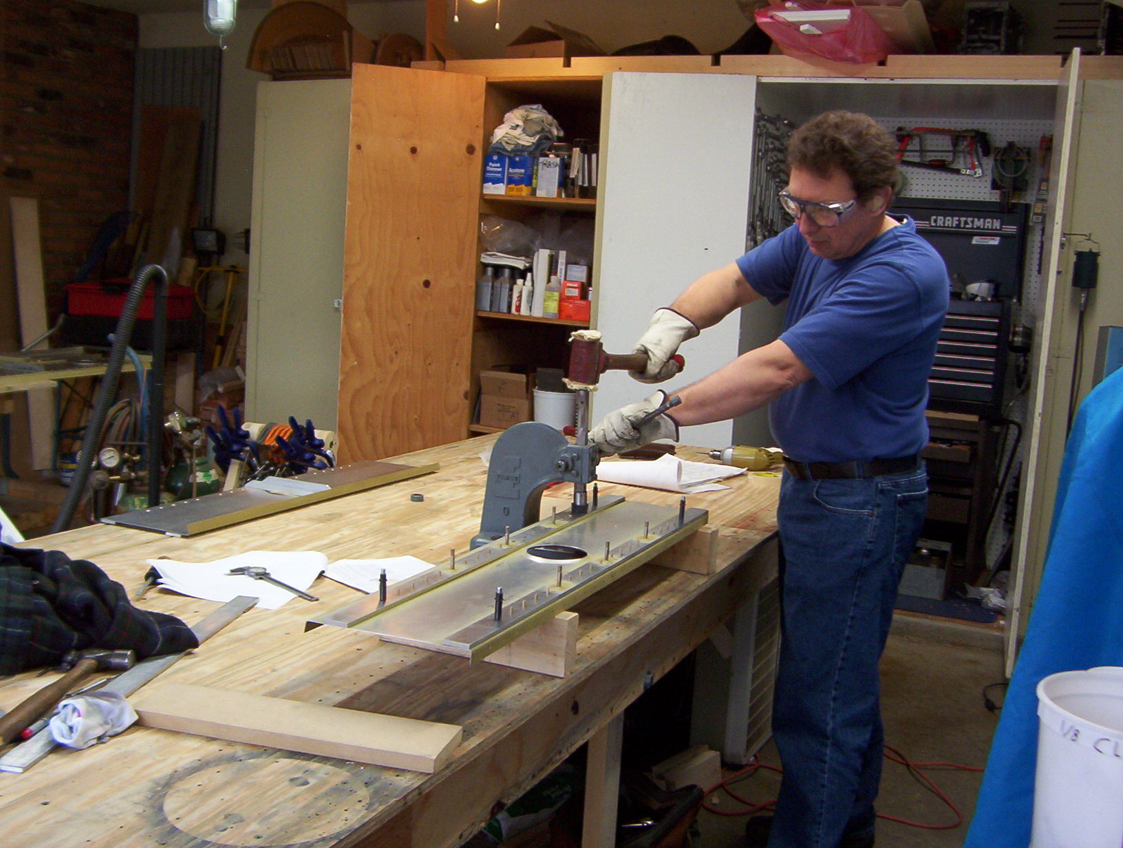

PostPosted: Sun Jun 01, 2008 12:07 pm    Post subject: Re: Building Spars Reply with quote
I built mine and hand hammered all the solid rivets in a 1 ton arbor press.
Views of the tools:
http://mykitlog.com/users/display_log.php?user=rlendon&project=113&category=0&log=22316&row=316
Riveting machine
 Filesize:  750.25 KB
 Viewed:  642 Time(s)
