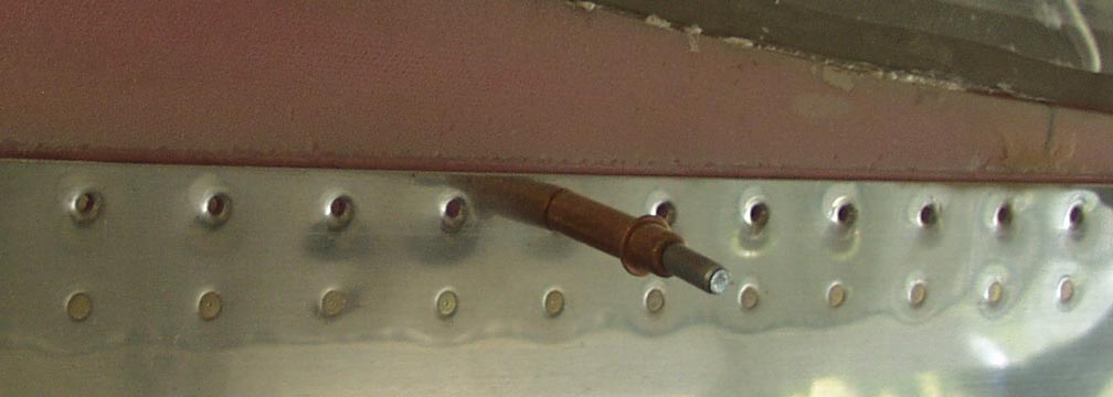

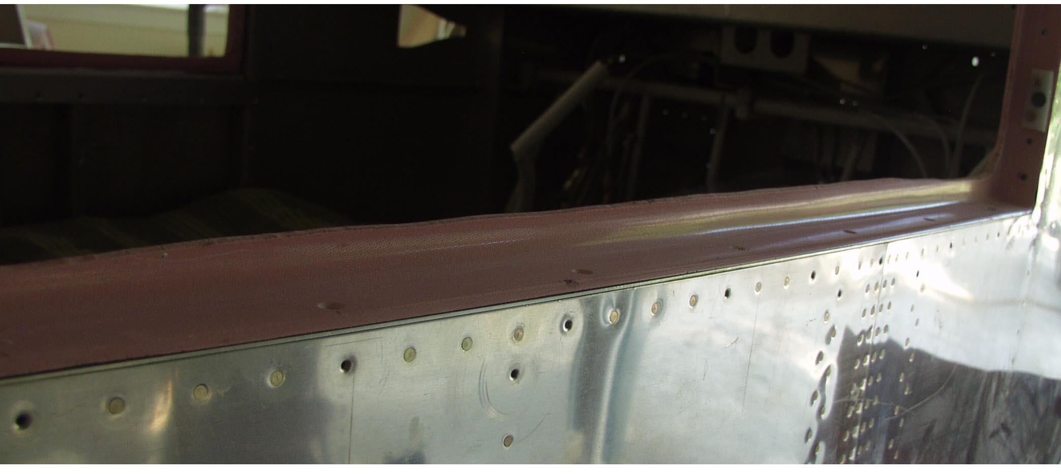

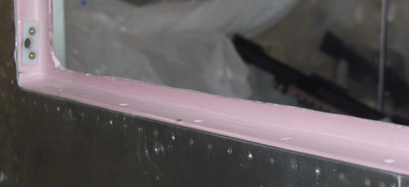

Just to second the others -- I stopped when the door sill started to look thin, and left the gap that Tim says will be filled at final fit before painting.
Here are some pictures I took today so you can compare. At one point I noticed that the edge along the longerons needed to be shaved to allow the cabin back to settle as I shaved the door sill -- it's a bit fuzzy (too lazy to climb inside to take the pic) but see "interior cabin gap".
Later, - Lew
