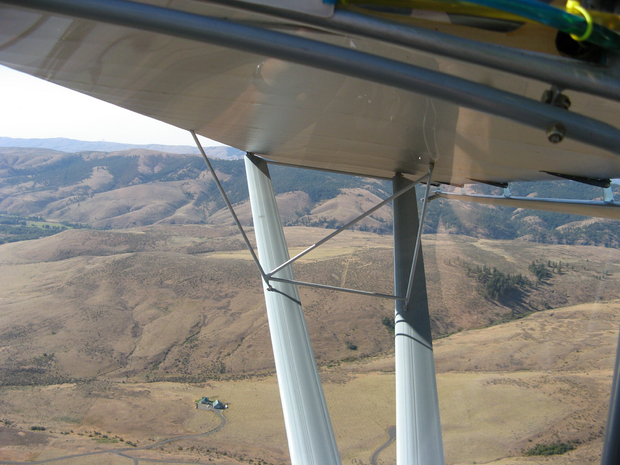

I have a set of wood wing strut fairing. They weigh eight pounds so I guess they may be about 10 pounds total when installed. I would like to somehow temporarily install them to find out if the benefits outweigh the weight gain. Does anyone have a good idea how to securely attach them for some testing and then be able to easily remove?
My classic 4 has a small engine so every ounce counts.
testing and be then be able to easily remove?
Sure. Duct tape.

Guy, I was thinking duct tape but it seemed so simple that I thought I must be missing something.
Dave and Gary, five to eight mph would be a good gain. Cruise now is 75 mph at 5800 rpm. I'm not really concerned about going fast. Rate of climb is a priority to me. Solo now is 800 ft/min but drops significantly with more load. At max gross (1050 for the classic 4 with 503) on a cool day it climb rate is 400-425. I would't even try it on a hot day here.
I like the looks of the faired struts versus the round and I think the wood fairing will add some strength too.

Well the wind finally quit blowing in windy Ellensburg this morning so I was able to test the wood strut fairing attached with duct tape.
Near as I can tell true air speed at 4000 feet DA and 5800 RPM increased from 78 mph to 82 mph. Climb rate did not change.
The biggest supprise to me was the sink rate at a 50 to 55 mph approach speed decreased a lot. I made my normal close in base to final and over shot the first two runway exits. I tried a second landing and was way high over the threshold again. Is there a logical reason for this or do I just need to learn to fly again?

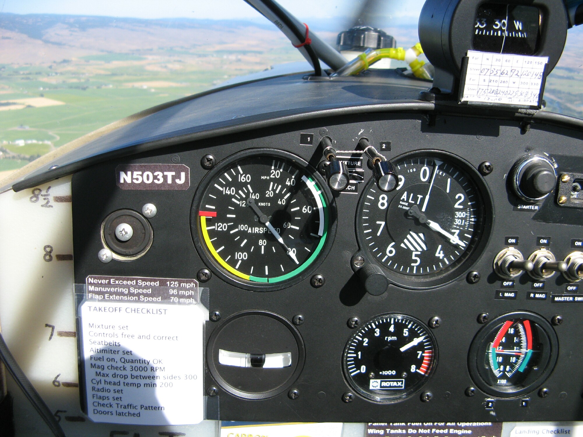

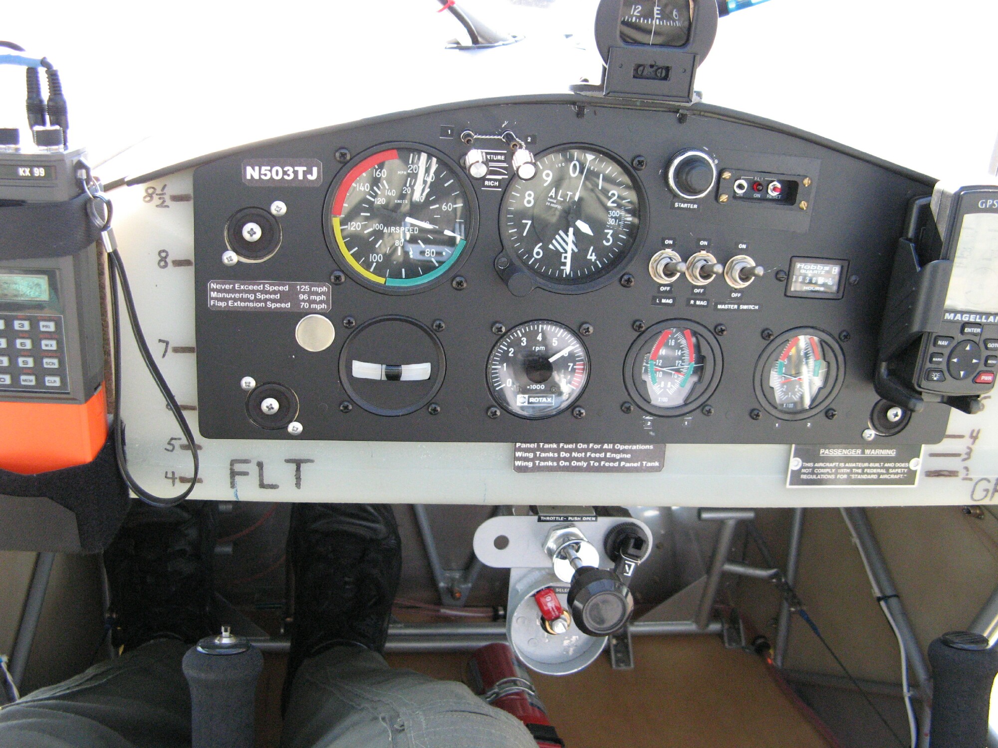

I looked at the PVC fairing at the Arlington Fly in then ordered a set. I test flew yesterday. Check out the attached pictures of the Airspeed before and after. You will have to take my word that these are both straight and level. I don't have a VSI. This is a Classic 4 with a 503 mind you. I am pleasantly suprised!

Hi Tom C  that looks pretty good for the strut fairings.  About 10 MPH!!  Just curious C how did you end up with a front tank in a Kitfox 4?  I thought they went away with the Kitfox 2.  Do you also have the wing tanks?  Jim Chuk  Kitfox 4 building C Avid MK IV flying C  MN

> Hi Tom C I installed the PVC type fairings in May of this year and got about 6 to 8 mph increase in cruise. I had all the balsa cut and spade when these came up for sale C and the installation is a lot simpler.

I forgot to include the weight of the PVC fairing in my earlier post. Bare fairing with aluminum cuff for lower ends was 11.5 pounds.
For what its worth department. I reweighed the airplane after fairing instillation. It has gained 26 pounds total since I weighed it a little over a year ago.
Besides the fairing this weight includes a fire extinguisher, hand held radio on the panel, hand held GPS on the panel, portable intercom on the butt rib, operator's manual and other paper work, baggage sack with 1/4" plywood bottom, plus all the miscellaneous clamps, screws, fire sleeves and such that continue to find their way into and onto an airplane. It all adds up to some pounds after a while.
