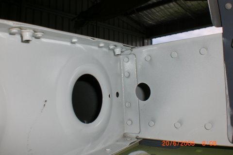

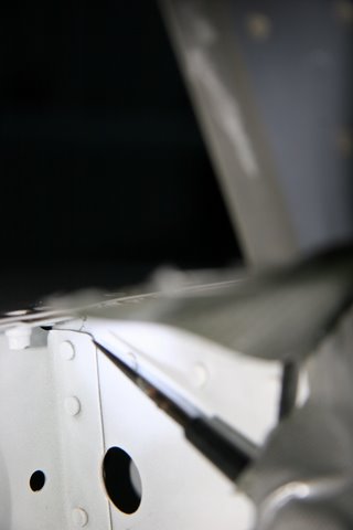

I posted two days ago about problems with cracks in the HS on Rv's. I am
now aware of an RV6 and an RV6A that both have cracks in the corner of the
HS just inboard of the first rib. The crack is in the thin walled channel
that is on the aft side of the front spar. The common denominator is that
both planes were early QB kits.
I have attached some pictures (not very good) of one of them.
Mick
