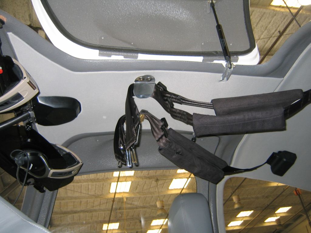

I didn't sand the aft section at all, except maybe a cursory swipe with 80G
to get the big chunks off.
The forward part between the doors took a bit of grinding to get it smooth,
maybe 10 gauge wire by your scale. Then, a piece of flat lexan went over
that area and was subsequently covered with headliner material. That
covered up a lot of unevenness.

In the back I glued a piece of 1/18" soundproofing foam (from Spruce) and
then the fabric. The fabric is pretty thin and will show unevenness. I did
sand and fill the canopy first. In the front I have an overhead console and
covered the rest of the area with some pieces of very thin aluminum wrapped
with fabric so little prep was required.

Ask Abby at Flightline. She says very little finishing necessary.

Abbey has a bunch of different fabrics that cover up a lot of sins. If you insert a piece of thin plastic like the trim taken off the wing tips you could probably conceal it completely. My only big suggestion is to install the fabric with the cabin top off the plane and upside down. (After you install the windows). Makes the job much much easier.
