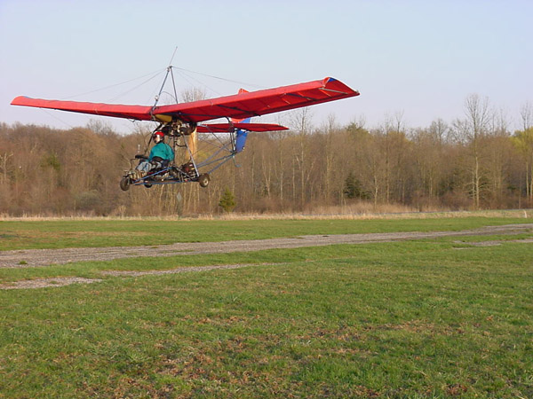

A member of the USUA club I used to belong to, flew a QS Sprint. It took: a 20# dive belt around her waist, 10# exercise weights on each ankle and 30#'s of shot in the overstuffed seat cushion she used to get to the recommended pilot weight of 170#. (I think I remember the numbers... If not exact, they are very close.)
The attached image is of her in flight.... the only obvious thing in this image is how high she is sitting. (Considering that she is about 5 feet nothing tall.)
kmccune wrote:
Yes it is, I have just never experienced one that needs a min pilot weight to get the nose wheel to touch! It kinda freaked me out!
(((((SNIP))))
