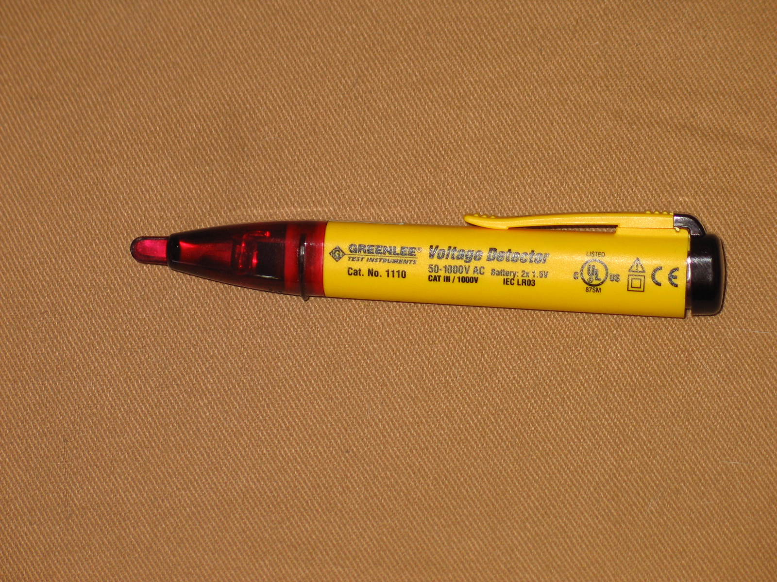

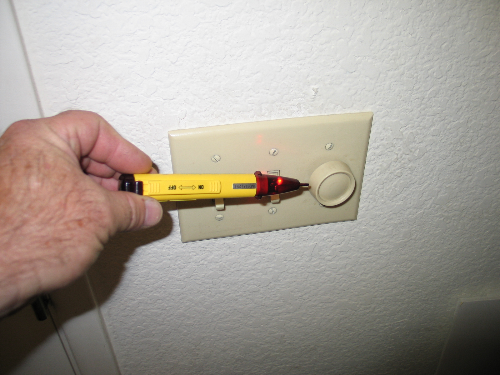

Here is an easy way and a tool to check your plugs and plug wires. Here is a picture of a AC tester, cost about $12. Spark plugs are AC current. This tester works by just getting the plastic probe next to the item you want to test. Start the engine with someone you trust at the controls and chock the tires. Then while the engine is running hold this tester up by each plug wire and then the plug. If you are getting a good current flow the light on the tester will light up steady. If you have a problem wire or plug the light may flash intermittently or not at all. This way you can trace down the exact place where the problem is occurring. You can test each plug wire coming out of the ignition modules and trace it down to the plug. The plug wires coming out of the ignition coils are screwed in just like they are at the plug cap. I think you will find your problem in the wires. I had a problem like this 4-5 months ago and the tester traced it to the #1 plug wire at the plug cap. I unscrewed the wire trimmed off about a 1/4" and screwed it back in and the problem was gone.
