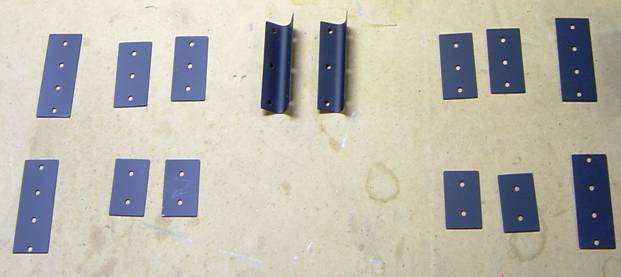

Try making some shims from 0.040 6061-T6. My spars were also bowed slightly as you described.
I inserted a picture below. If you can’t see it, try viewing the email as HTML, or email me off list and I can send you the file.
The two parts in the center of the picture are the attachment doublers, not shims.
Scott
Ke4hrh(at)comcast.net
Scott

I put in shims where the two outboard ribs attach to the spar.
I also found that the precut slots for front attachments needed to be ~3mm longer before I could get the pre-drilled holes on BOTH sides of the stab to align with the skeleton. Just check where the holes on the top side are going to be before you drill the bottom!!
