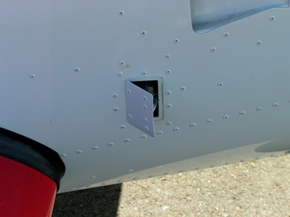

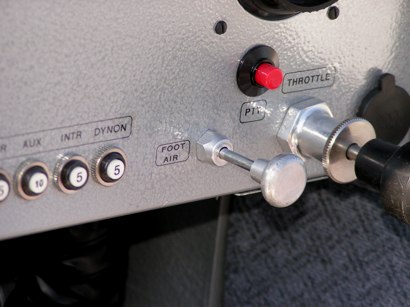

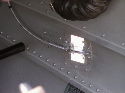

My 601XL is now flying, and it is hot here. I have found a wonderful air vent that others might want to try.
It is from Vans. I got two for $18. I put one on the passenger side of the 601.
It sticks out into the slipstream and blows a blast of air across to the pilot - even on the ground. I highly recommend it.

Looks nice. Got a link to where I can order it from?
And is there any speed limitation on its use?

I got it from the Vans web store.
http://www.vansaircraft.com/cgi-bin/catalog.cgi?ident=1219012338-374-180&browse=heatvent&product=10vent_kit
There is no speed restriction that I know of...........Fred......N9601
