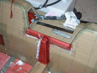

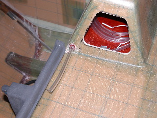

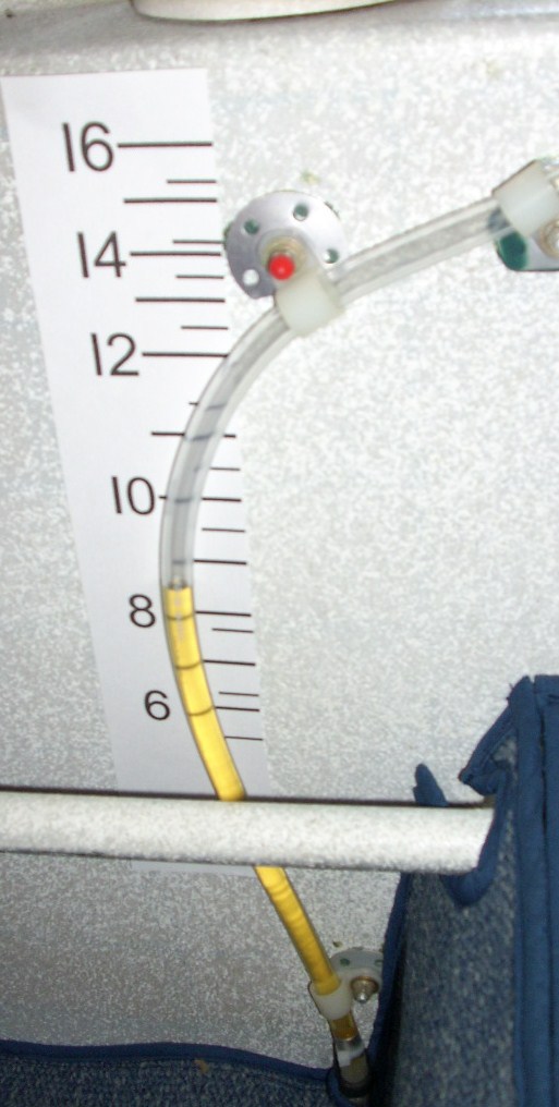

Greg...per your request, a couple of pixs of my installation. Note that
my intention w/ the tween-seats sight tube is to have a visual check
while refueling, and to meet a regulatory requirement for a 2nd means
of determining fuel on board; during flight, my expectation is to relay
upon the Europa-mod fuel gauge and digital instrumentation. Note that
the sight gauge in this location shows only fuel above top of tunnel.
Hope these help,
Fred

Thanks for the pics. Nice installation Fred, and a great way for a refueling
check. The extra bidding is a good way to keep the surface flat. It looks
like the end fittings are plastic, as well. Any ideas as to the type of
sealant to use on the pvc-pvc fittings? I wonder if the standard pvc cement
will work, that is if it acts as a solvent and melts the plastic together,
it might be doing the same thing as the heat welds. What did you use?
Since yours were turned, I imagine some sort of sealer?

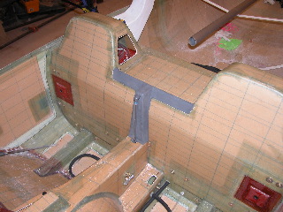

There is a big possibility I will install the site gauge in the front of the
seat back area, between the two seats.
I have also heard of others placing it in the seat back area behind the
seats?? If anyone has a picture or link for that installation, let me know.
I would like to evaluate both, before committing.

On Friday, Aug 1, 2008, at 18:48 US/Pacific, Greg Fuchs wrote:
| Quote: | It looks like the end fittings are plastic, as well. Any ideas as to
the type of sealant to use on the pvc-pvc fittings?
Greg,
I tapped the tube ends to match up w/ a Nyloc nipple which threads into
an aluminum 90 degree fitting at the top which is barbed on the other
end to receive the vent tubing...the bottom of the pipe (not shown) is
threaded to receive a Nyloc straight fitting which is barbed on the
other end to receive the 5/16" teflon lined fuel injection hose which I
used for the balance of my fuel system (aft of the firewall). All
fittings from Acft Spruce; I used standard automotive thread sealant.
Fred

or other fuel-related extras (second tank input, last-chance backup, or
whatever). The goal is to have a flow rate meter to tell the pilot how much
fuel is left, unless the tank begets a leak. Although unlikely to not have
other sensory inputs like smell, the first backup would be the mechanical
float. From reading other emails, the poly tank topside might ripple over
time. Because of its narrowness, it wouldn't take much movement (whether it
be rippling, or tank-top sender nut becoming loose, from the vibration) for
the throw of the mechanical wand to stick on the sidewall of the lower tank.
If one knew this was happening, it would be an easy matter to re-adjust the
wand in the tank. On the off chance that it snuck up on the pilot during
flight, it could make it seem that there is more fuel in the tank than
actual. Thus I like the simplicity of a third backup system being a sight
gauge. You can pretty much trust that you have what you see, if it is
installed properly. And if installed into the passenger side, it would allow
inspection of the reserve fuel, which is information that my one-float
system doesn't currently have, in its non-upgraded state. A good inspection
frequency would mitigate one caveat of the sight gauge -possible leakage due
to breakdown.

The factory supplied sight gauge tubing is polyurethane (see Chpt 30). We noticed it was getting hard to read because of yellowing and also very hard and brittle after about 2 years exposure to auto gas. Decided to replace it during our after ground loop rebuild.
Went to the Tygon web site (www.tygon.com) to find alternatives. F4040A is listed as fuel tubing. However Europa supplied a length of that with our Long Range tank. The F4040A was inside the main tank and exposed to gasoline. After about 2 years it not only was virtually opague but it was hard and brittle. Decided against F4040A.
Tygon Tech rep suggested Tygothane C210A or Tygon SE200. Tygothane C210A is polyurethane without plasticizers. It should hold up to gasoline well. SE200 is PVC with a teflon liner. A search of literature suggests teflon is one of the most gasoline resistant materials.
We cut short sections of F4040A, SE200 and C210A filled them with auto gas and plugged both ends. The gas eventually leaked out of all of them, but it was out of the F4040A in a day or two, C210A about a month and SE200 took 3 months. We also put short pieces in a jar of auto gas. F4040A has discolored and gotten much stiffer in 3 months. C210A is discolored but not stiffer and SE200 the PVC has shrunk but the teflon liner has not changed.
So we are using SE200 for our sight gauge. For the Long Range tank feed, we used C210A. We also measure fuel quantity with a pressure sensor similar to Tony K's system feeding an input to our GRT EIS and the EIS calculates fuel usage from flow transducers.
Attached is a photo of the sight gauge up the back of the cockpit module.
Jim & Heather Butcher

Ahhhhhhhh..........Its like this information is just the prescription my
doctor ordered.
Sounds like SE200 and C210A are the clear-cut winners, depending on the
application! Thanks for the update on the experiment.
I got the picture link, and will print it out. Thanks for that. It will come
in handy.
I am looking for a 'packet' of info, or anything I can get about a fuel
'head' pressure measuring system (the time needed to completely reinvent
this wheel would force me to a new path, I admire the time some have spent
to create this soln). Let me know if you have info on this.
Thanks again,
Greg
....snip..........
