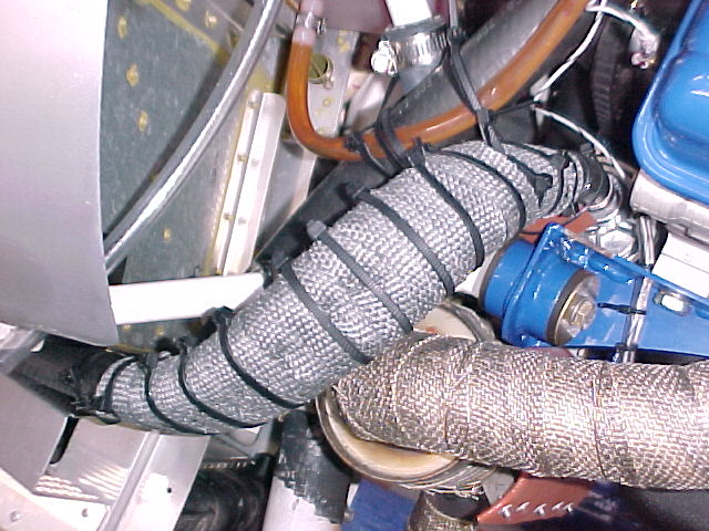

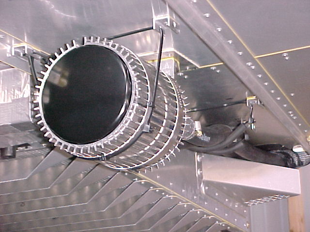

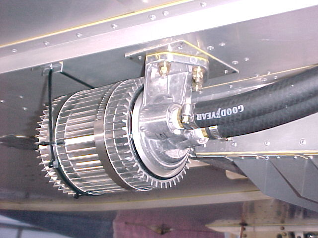

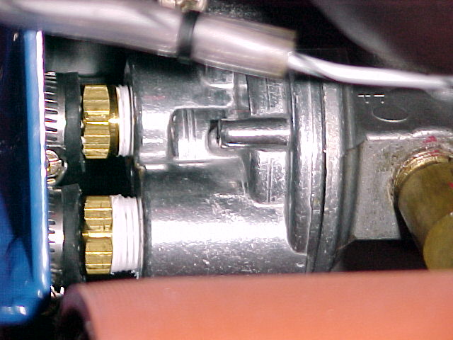

larry(at)macsmachine.com Guest
Posted: Thu Aug 07, 2008 2:37 pm Post subject: Remote Oil Filter ? |
Hi Andy,
I've a friend Kelly Meiste who has a Stratus EA81 that uses a JC Whitney
sourced remote oil filter. A bit different, but
he says it works well, uses a standard size filter and reduces the oil
temps by 10-degrees or so.
Pictures attached
