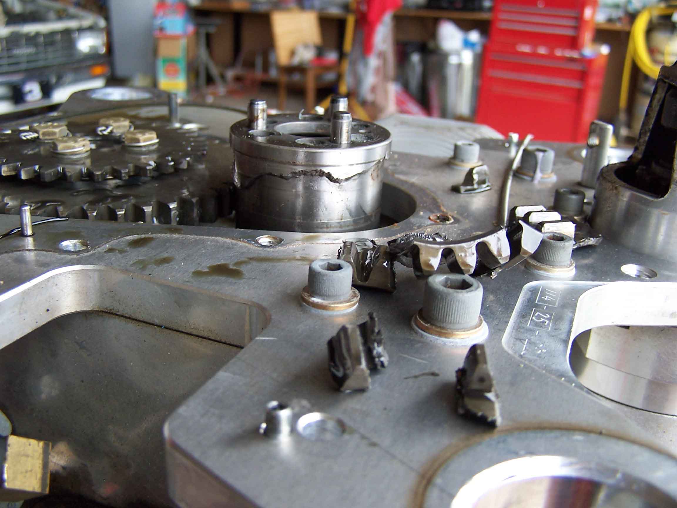

Here's the tale of the engine stoppage...as I suspected, the timing
gear on the crank destroyed itself (actually I didn't guess the crank
gear specifically, rather one or the other), but the end result is
the same. I've got one head off and slight contact between the valve
and piston shows, but I don't think new parts on that one cylinder is
required, but I've got 3 more to look at tomorrow. In any case, I'll
probably do a complete o'haul as long as I have it this far down.
The crank gear looks like some hockey players I've come up
against...about 9 teeth missing. : )

I'm sorry to say that, from an engineering perspective, that's a very
sorry looking gear. I'm also wondering what the heck the little flat
gear is for. I sure hope they redesigned this area at some point.
(The picture in the field looks great, however!)

Yup... That would just about stop the engine... I wouldn't have thought
there would be enough load there to do that! Do you think there may have
been a defect in the gear?

The little flat gear is the drive gear for the distributors. There
are two more similar gears, one on each end of the dist shafts. Since
very little driving force is required for the dist shafts to turn, a
thin gear is all that is required. Explanation aside, they ARE very
wimpy-looking though, eh?The strange thing about this crank gear is
that it is hat-shaped, and sits over the end of the crankshaft,
positioned by the dowels, and held in place when the flywheel is
bolted on top of it...top as seen in the picture. The scored line
about 1/4" down from the face of that gear is the line made from the
rear oil seal riding on it....that's right, the seal rides on this
gear, not on the crankshaft itself. The engine is a marvel of
compactness and design, but that's not to say that it's without its
flaws, and it seems like I'm the poster child for finding some.
In hindsight, when I noticed some oil seepage at the rear seal area,
I should have looked further. But oil seepage doesn't immediately
tell me (DID'NT tell me, but it WILL now!) to pull the engine and
have a better look. Maybe being a gearhead for years and years
doesn't translate directly over to aviation.
I took a better look at the crank timing gear, and there are signs
that it was cracked for some time...how long I couldn't say, but it
just didn't happen all in one shot.
I'm building an engine stand this morning, and will get the rest of
the engine dismantled later today.

I'm pretty sure there was....the crack shows signs of age, just not
an immediate fracture, the way I see it.
Jabiru might want to take a look at it.

Nope, I've got solid lifters...mine was the 5th engine from the last
of the solid lifter engines. (Maybe they were using up all the bad
parts in an effort to clean out the bins when they made mine) The
only recent clue that I had was a slight seepage from the rear main
seal. I couldn't really tell where it was coming from in the weeks
prior to the failure, but I knew that there was some oil showing up
on the lower cowl. I attributed it to a combination of seepages from
various areas as the engine got more and more hours on it, and
because it was not a lot of oil, just an oil film really, I never
went looking for one big major problem. Then at Oshkosh when I saw
the oil seepage...more than a film of oil this time....coming from
the rear main seal area, I knew I had to do something about it. Well,
it only gave me about 5 hours notice...barely enough time to get back
from Oshkosh. Someone mentioned that if the broken part was cracked
in the area where the seal rides, that could explain the leak leading
up to the part failure.

that rear main seal area. Because of the nature of the design of the
engine, a leak here is a warning. Any other seal seepage is just an
annoyance, and can be dealt with in time, but I'd treat this area
with respect and look into a leakage here sooner rather than later.
For anyone thinking about using a Jabiru engine, I seem to be the
only one having these problems, so maybe I got a "Friday afternoon/
Monday morning" engine. The majority of them out there are performing
without problems, both in experimentals and in the Jabiru aircraft.
Lynn Matteson

The head engine builder (Don) at Jabiru just called me and we ran thru your timing gear failure.
Jabiru Australia have one (1) reported Crankshaft Timing gear failure and this happened three years ago at Innisfil (S.Australia) on a Jab2200 powered lightwing.
The gear was inspected at Jabiru and heat treat and mfg were all within spec. There were no signs of contamination between the gears and the final consensus was that the operator may have been experiencing pre-ignition or was running with a loose flywheel which could have over-stressed the gear.
The gear only runs the camshaft at a 2:1 ratio and is very lightly loaded so with over 1500 units in operation and only one recorded failure that could not be attributed to component overstress no service directive was issued.
They have released directives to ensure all fly-wheel bolts are correctly torqued.
Sorry I couldn't get you a more definitive answer but it appears that this might have been a 1 off (or 2 - off)

I haven't said anything regarding my engine failure on either of the
Jabiru lists, Matronics or Yahoo...yet. I will when I have something
to say, (wink, wink). Still waiting to hear back from Jabiru...they
have been informed of the incident.
Michel, I was right behind you on the flywheel bolt issue...my engine
had the dowels already in place, the existing bolts were tight, and
the engine lasted a good 300 hours (I'm guessing, since I'm not where
my records are) since I complied with that Service Bulletin. Boy,
that was a busy time on the ol' Jabiru site, eh?
My oil was seeping from right below the rear main oil seal. If you
recall, the timing gear provides the surface upon which the oil seal
rides. It's a rather strange design, unlike any I've seen in all the
engines I've dealt with over the years, but then we're in the
aviation world now, where lightness, compactness, and engineering
done to the Nth degree is commonplace. You have to look behind the
flywheel, Michel, from below, to see the area.
I could kick my ass, in hindsight, for not getting right after that
leak after I first saw it. Like I said before, a seeping seal is not
the reason one normally pulls the engine and goes after it. After
all, it's only "seeping", not pouring out, threatening a fire, etc.
But looking back on it, that's what I should have done. Actually, the
repair could have been done with the engine still in the
plane...barely, in my case. The rear cover is all that must be
pulled, and this requires taking the flywheel off. After that is off,
the timing gear cover can be removed, and the timing gears are then
exposed. Even taking the flywheel off and pulling the seal might have
revealed the crack in the timing gear, which in my case could
probably have been seen at that point. From the looks of the broken
pieces, this has been a faulty gear for some time.
My serial number is 2062, Michel, just 5 engines before they went to
wet lifters (hydraulics)....what number is yours? Did you already
have the dowels in your engine?

Now, Lynn, where exactly did you see your oil seeping from? I
understand that the timing gear is behind (or rather, in front of,
if you look forward) of the flywheel. But I am not sure where the
oil leaks from.

I did the service bulletin at the time it was issued, and I changed
all the bolts, the originals of which were already at the then-
current torque specs, so no "loose flywheel" at that time. No loose
flywheel at this time either, and no fretting was seen when I took it
off this time. My engine (#2062) had the three dowels already fitted.
Unless they'd like to see my broken gear, and give me some new parts
(yeah, right!), I guess I'l just buy new parts and get back to flying.
Lynn
correctly torqued.
best regards
Gary

I have been reading posts on this with great interest. Lynn, I had a
good look at your plane at Oshkosh. It looked great. Who would have
known that it was a few hours away from a situation like you
experienced?
On your seal leaking issue I keep thinking of my experiences in the
auto, snow machine and boat world. In my head I keep coming back to the
fact that in low hour machines or ones that have seals that are only a
few years old a leak was often a sign of a bad bearing or bent shaft or
an out of balance component. Could the cause of your failure be a
bearing on either end of the shaft going bad? Maybe a flywheel balance
weight came loose. In that geared arrangement it wouldn't take too much
slop to really hammer those gears on each other until something lets go.
Just a thought and good luck.
