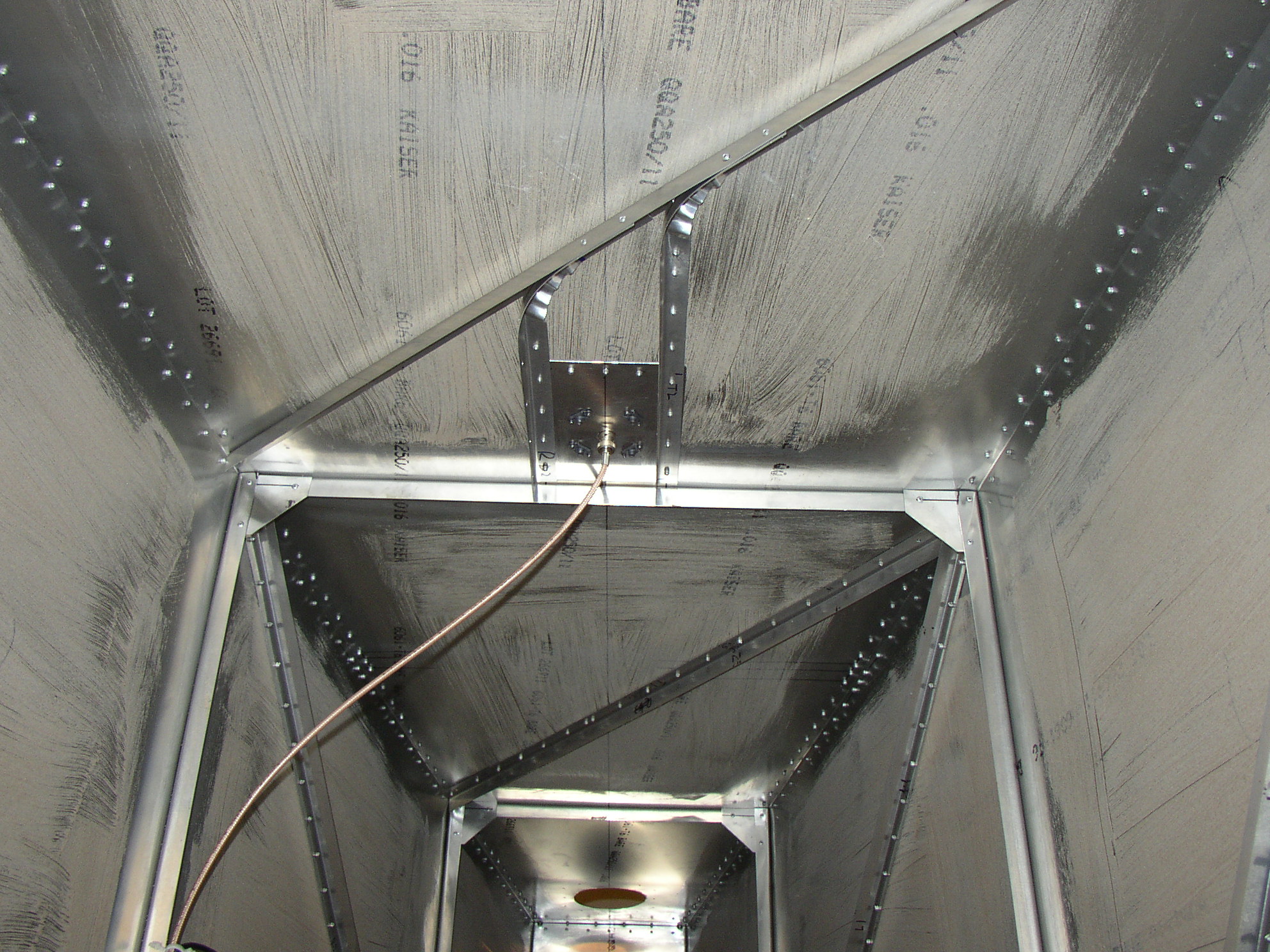

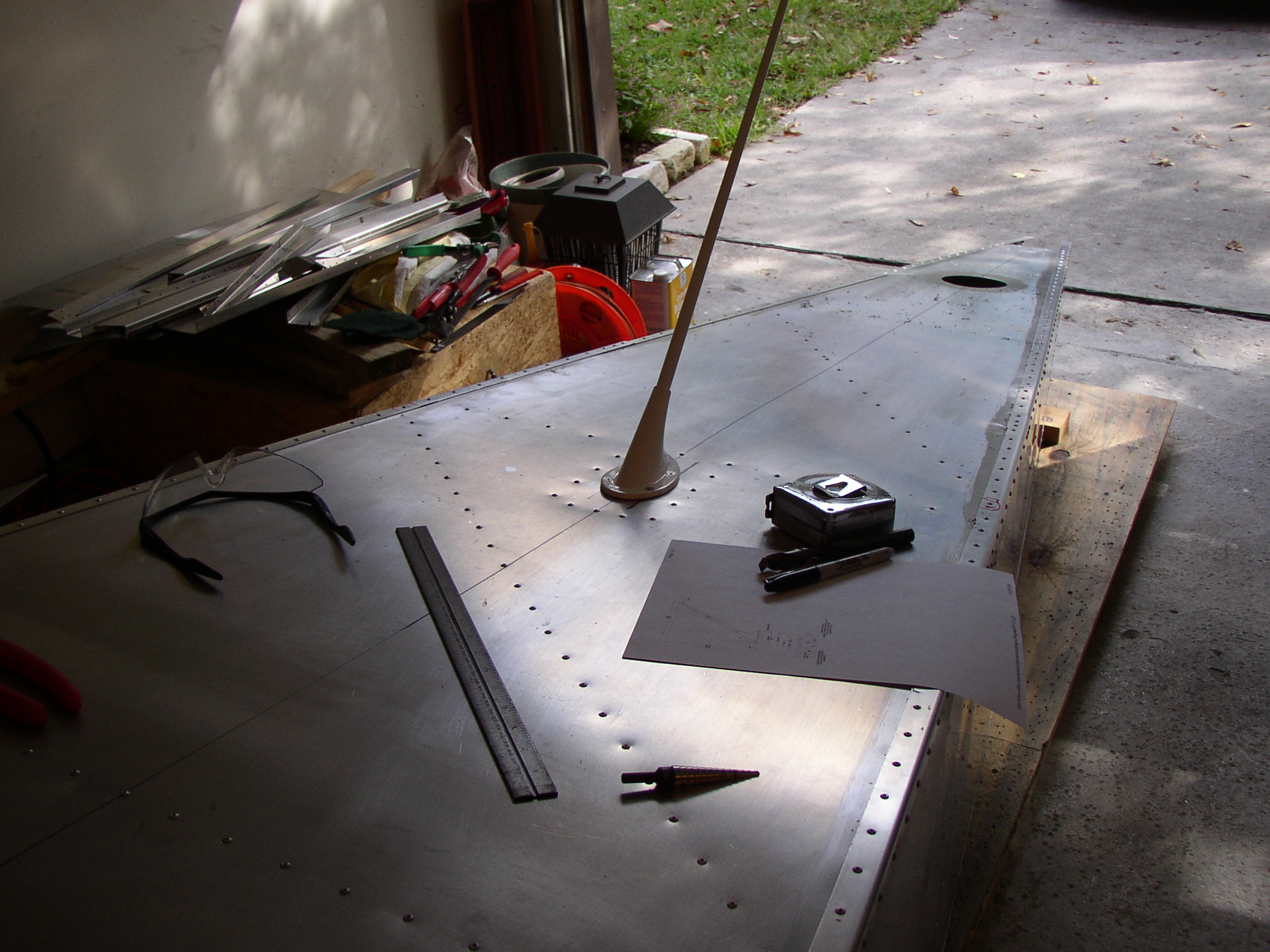

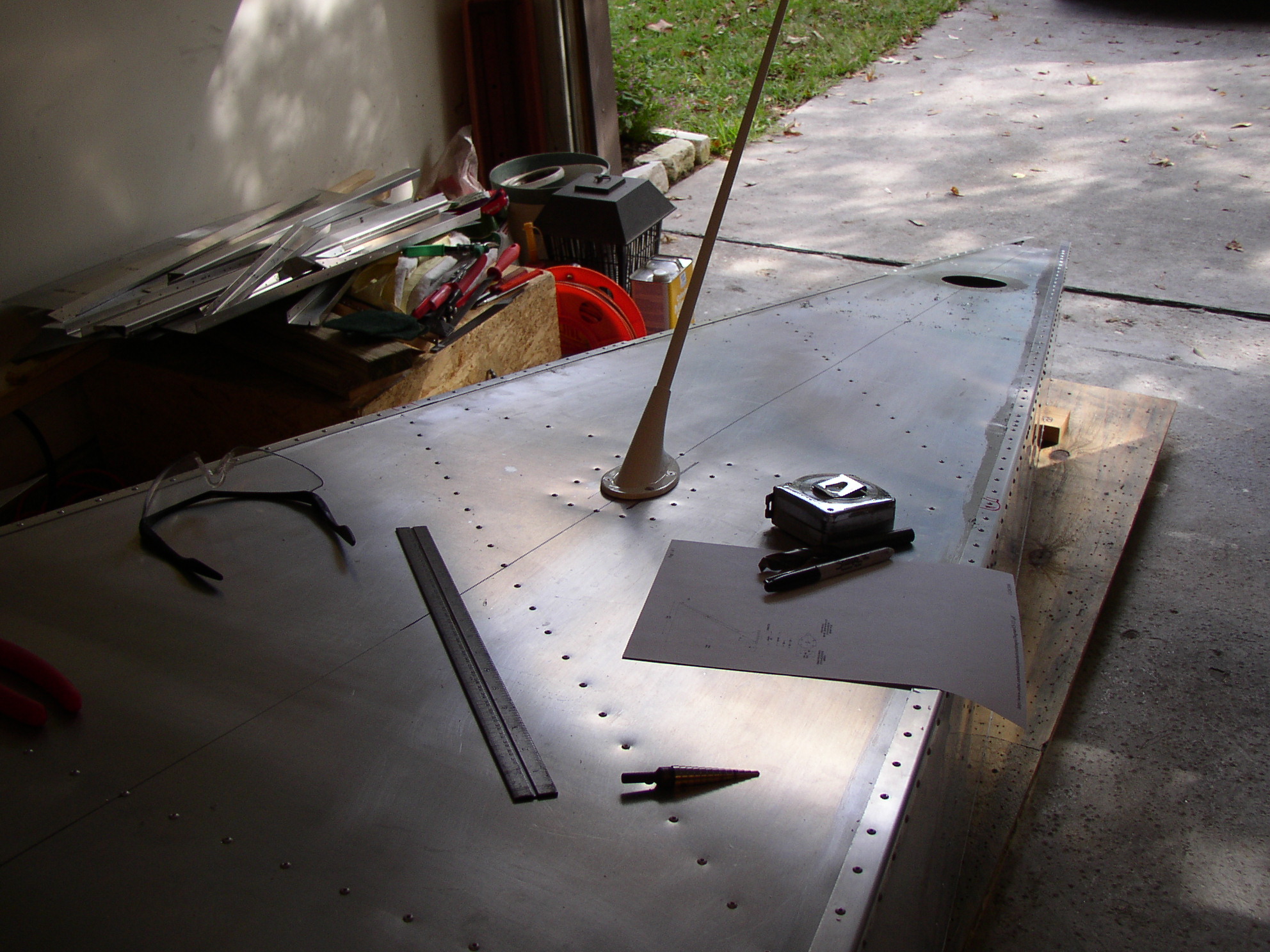

PostPosted: Wed Aug 27, 2008 7:40 am    Post subject: Re: CH701 Antennas install - backing plates Reply with quote
Keith,
Regarding the transponder installation, some units require an antenna cable no longer than 6 feet. You may want to check with your avionics guy or Bob Nuckoll's website for your specific transponder.
I have a KT-76A with the antenna on the cabin floor, between the firewall and right rudder pedals. I haven't flown yet, but my avionics guy says the antenna placement is fine.
Regarding the com antenna, I placed mine on the top skin behind the baggage back (leave enough room for 7C6-4 - forward fin!). I added an access panel in the baggage back for accessibility to the antenna. Hindsight being 20/20, I would much rather have placed the antenna just ahead of the baggage back for ease of maintenance. I'll enclose pics.
I used a .040" backing plate along with 'L' brackets attached to the frame.
Hope this helps.

PostPosted: Wed Aug 27, 2008 3:17 pm    Post subject: Re: CH701 Antennas install - backing plates Reply with quote
List, Please forgive me for going off-topic here, but Dan, what is the substance brushed on the aluminum in your 2nd (interior) photo of the antenna?
--Mark
txpilot
Joined: 26 Feb 2007
Posts: 87
Location: Houston, TX
PostPosted: Wed Aug 27, 2008 4:42 pm    Post subject: Re: CH701 Antennas install - backing plates Reply with quote
--Mark
Sorry Mark, but I can't remember the name of the product. It does two things: it acts as a corrosion inhibitor and supposed to stiffen the .016 aluminum to prevent 'oil-canning'. Although it seems to work well as a corrosion inhibitor, it doesn't help with the oil canning so much. That's why I added the diagonal 'L' brackets (which work great!).
Another 20/20 hindsight: zinc chromate or Cortec would have worked just as well as that crap and probably would weigh a lot less.
Dan
