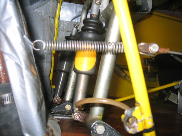

At my wits end... which in my case might not be all that far.....
I am having problems with my hydraulic brake cylinder and cannot figure it
out. Trying to resolve ground looping problems - always to the right - I
discovered that the left brake "fades" quickly so on applying brakes on a
short runway I sometimes ended up slow-looping to the right despite pressing
as hard as I can on the left brake.
In a previous post I asked how to top up the fluid and did the
pump-from-the-bottom-til-it-squirts-out-the-top thing and it seemed to be
better on quick-stop tests, until I looped again. I have attached a picture
of the cylinder as I don't know the manufacturer.
I took apart both cylinders, the left one had an O ring at the top that was
the wrong size and not seated properly. I thought "aha!" and replaced that O
ring on both with proper sized, and also the ring on the piston. Cleaned
both thoroughly, pumped old fluid out of the system bottom-to-top,
re-installed both cylinders and pumped til it came out the top screw, and
tested. Right one fine - left one makes gurgle noises and goes full travel,
no fluid leaks. Once it bottoms out - no more left brake.
I disassembled the left one again, filled it with fluid with no parts in it
to ensure no air, put parts in and sealed the outlet rather than attach the
brakeline, reassembled and pushed on the plunger and it still bottoms out
with gurgles. All parts are identical in both cylinders, seem to fit the
same, yet one develops pressure and the other gurgles (sound of fluid
through an orifice more accurately).
I see there is a hole in the piston and that if pressure is placed on it in
compression it seals, at least it does when I lip test it. The spring in the
piston tube that provides that pressure is loose and springy as it should
be. Testing both cylinders the same way they appear to be the same.
I'm stumped - any ideas what to check next? All
guesses/wisdom/answers/advice appreciated in advance.

7suds(at)Chartermi.net
PostPosted: Tue Aug 26, 2008 2:46 pm    Post subject: Give me a brake! Reply with quote
Bob,
Not an expert, but it sounds to me like you are on the right track with the
hole through the piston. Can you possible find a way to plug it temporarily
and re-try your test, if there is no fade you found out where it is going,
then you just need to figure out why, maybe switch the spring from the other
brake. I was also going to add that when I purge my brakes I have a small
submersible pump in a can of brake fluid and a hose coming off the top of my
reservoir back to the can of fluid, as I cycle fluid through I work both
brake cylinders for that brake. Works very well.

Bob, just to be sure we are not overlooking something basic I will go ahead and ask it. The brake line in your photo appears to be full of either air or clear brake fluid. You are using red aviation brake fluid MIL-H-5606, right?

That was my next thought Lloyd - exchange parts, especially the piston,
between working and non-working. I need to buy more brake fluid first though
to do that test as I haven't been keeping the test fluid clean enough to
re-use. And exactly what fluid to use is the subject of a response I am
awaiting from Tom Jones, although other than viscosity I can't see how it
might affect the problem. I'll try anything!

Do not recognize the cylender. But here is an idea. I think there is a valve
in the piston. It sounds like it is in backwards or missing. Something like
a check valve. It lets you build pressure one way and flows the other way.
It may be as simple as a ball that is crimped into a hole through the
piston. Something to check.

Bob, those are matco brakes. You can get the re-build kit for around 15.00. I re-built mine. Check the bottom of the plunger and make sure the little round rubber disk is still in place. The o-rings need to be Buna-n or they will deteriorate fast.
http://matco.elixirlabs.com/users/matco/images/mastercylinder13a.jpg
This is the link to the parts break down for the master. This shows the new model master, but the note calls out the parts needed for the old style that you and I both have. If you call matco and tell them what you have the tech guy is real cool and will hook you right up with the parts you need. The ship real fast too. Any airport FBO should have some 5606 brake fluid.
www.matcomfg.com

Another thought. I think the little rubber "plug" on the bottom of the plunger may be the problem. When you get the re-build kit, you have to glue the rubber disk on, then sand it off to XX measurement (sorry I am at work and wont be home to pull the directions till the 5th) I though well crap, what they call for is only a few thousands less than what it comes out to be when you glue the whole thing on so I don't need to sand it.... well you could not fill from the bottom up as those few thousandths was enough to block the hole. I then sanded it off, put it back together and it did the same thing you are describing.. I was pissed as one side worked and the other didn't and I knew darn good and well I had put them both together the same... Well when I pulled it back apart, I had flipped something over on the left one just as I think you have, but I cant remember exactly what it was (I did it last year).. At any rate, I bet you just flipped something over when you had it apart.
Hopefully this will help you out.

http://matco.elixirlabs.com/users/matco/images/mastercylinder1a.jpg
Order rebuild kit MCMCRBD1.

PostPosted: Wed Aug 27, 2008 5:43 am    Post subject: Give me a brake! Reply with quote
Bob:
I've had the same experience as you and Lenny's advice is spot on. I'll bet you a beer it's the Buna-N plug that's the culprit. Your master cylinder is a Matco MC-1. The rebuild kit is p/n MCRBD1 available cheaply from Matco.
The plud is glued to the piston with any fast setting adhesive designed for a petroleul environment. Matco recommends Loctite Black Max. Plug is then trimmed to length per instructions included with the kit.
If the rubber boot is worn, save it! They don't use it in the newer models and no longer supply replacements. Here's the contact stuff I have:

PostPosted: Wed Aug 27, 2008 9:17 am    Post subject: Give me a brake! Reply with quote
Thanks Dave - you always come up with a variety of possibilities that others
may not have thought of and I appreciate it.
I got a quart of the proper Aeroshell MIL-5606 today from a local FBO who
happened to have a 1/4 full gallon can so I was lucky. I will purge both
systems and use that. The non-synth oil was only in for a few days although
I can't be sure what the previous owner used, but it wasn't bright red.
I will order the rebuild kits from Matco and replace all seals in the master
cylinders. The calipers appear to be fine, as I stated earlier I tested the
faulty cylinder stand-alone so as to eliminate the other possibilities you
mention below. From the links Leonard Perry sent it is almost certainly the
plug in the piston that is bad and I suspect it has been bad since I have
owned the plane.
Regarding ground loops - I thought it was me but in retrospect it only
happened when braking on a short roll-out, I applied brakes evenly (I
thought!) but then the hydraulic pressure in the left brake faded as the
piston leaks = all right brake going at 20mph. Try it - you'll loop too!

matronics(at)bob.brennan.
PostPosted: Wed Aug 27, 2008 9:23 am    Post subject: Give me a brake! Reply with quote
Leonard - I think you've hit it square on the head mate! These links are
invaluable and I will be ordering the repair kits for both cylinders
immediately. I also managed to score a quart of the proper Aeroshell brake
fluid so I will be replacing the fluid in both systems.
One thing though - I couldn't see how to disconnect the piston from the rod
to get to that plug, as far as I can see the piston is on a ball joint of
some sort. Hopefully the kit will provide instructions how to get to that
plug unless any of you have already done a rebuild like this?
Thanks again for the help - I love this list!

PostPosted: Wed Aug 27, 2008 9:45 am    Post subject: Re: Give me a brake! Reply with quote
Bob, there is a little snap ring that holds it in. Take a look at the pic in the link and you will see it. It is a little tiny bugger that I just used two picks to pull out.
