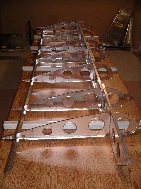

PostPosted: Sun Aug 31, 2008 5:06 am    Post subject: Re: Increasing Registered Gross Reply with quote
That is good advise, though I doubt that the 701 is that close the the edge. The Savannah is an almost direct copy and the wing is a copy (though extended a bit) of the older 701. Yet it is rated at both a higher gross and a higher Vne. And they are not exactly falling out of the sky. Here are the upgrade instructions from ICP to increase the gross on the older model when the 701 went to 1100lbs. They are available on the yahoo Savannah site if your wondering where I got them. When you look at them, look also at your 701 SP plans, it is interesting to say the least.
Kevin
 Filesize:  221.59 KB
 Viewed:  656 Time(s)
