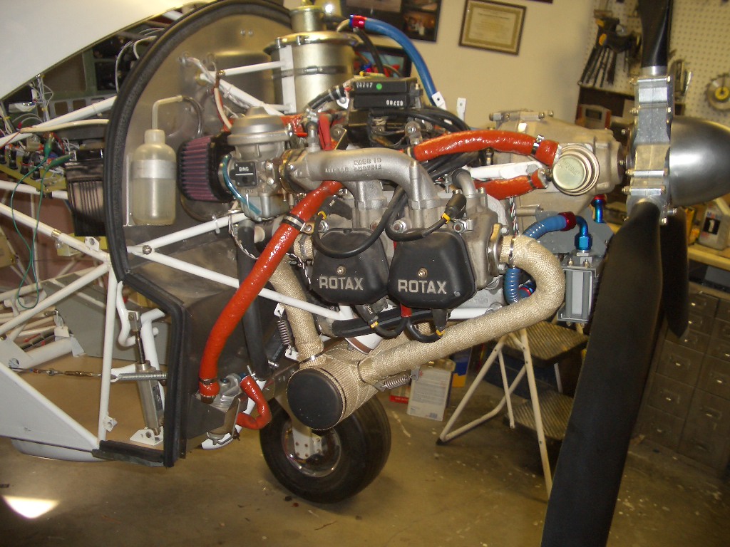

PostPosted: Sun Oct 05, 2008 3:58 am    Post subject: Re: Coolant overflow bottle placement Reply with quote
Lewis,
I did the same thing on my IV. I removed the conventional carb heat box and scat tubing, replacing it with electric carb heaters, and installed two K&N RU-1820 filters. Attached is a picture of the right side.
Keith Schneider
Model IV / 912
Waynesville OH
 Filesize:  257.23 KB
 Viewed:  542 Time(s)
Keith Schneider
Red Stewart Airfield
Waynesville Ohio
KF IV 912ul

I did the same thing on my IV. I removed the conventional carb heat box and scat tubing, replacing it with electric carb heaters, and installed two K&N RU-1820 filters. Attached is a picture of the right side. [quote]
Thanks Kieth. Your installation looks similar to mine in the amount of room you have. Unfortunately, the air filters I picked up are larger than yours. Here's a link to the picture:

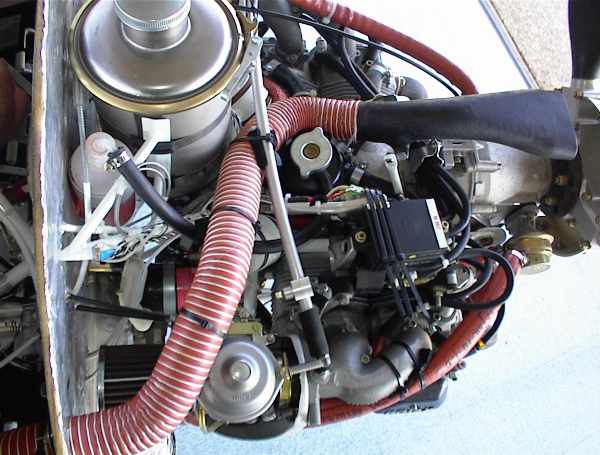

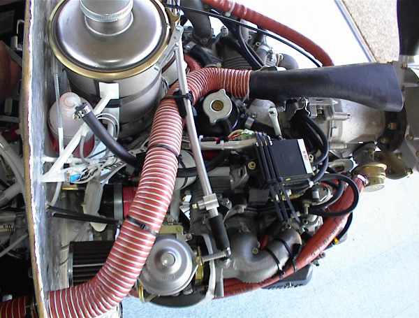

PostPosted: Sun Oct 05, 2008 3:29 pm    Post subject: Coolant overflow bottle placement Reply with quote
Luis,
I mounted mine behind the oil tank. Picture attached.
Lowell
 Filesize:  38.77 KB
 Viewed:  535 Time(s)

PostPosted: Sun Oct 05, 2008 3:39 pm    Post subject: Re: Coolant overflow bottle placement Reply with quote
Thanks Lowell. I was afraid I'd have to squeeze it back in there somewhere. It's nice to have confirmation. Two questions though:
Is your attached to the firewall or the oil tank support? It didn't occur to me until I saw your picture but attaching it to the oil tank support would save me having to drill through the firewall.
Also, what's with the scat tubing going to the front of the motor? Vent for the cockpit?

PostPosted: Sun Oct 05, 2008 5:10 pm    Post subject: Coolant overflow bottle placement Reply with quote
Mine was attached to the firewall. I do like the idea of attaching it to
the tank mount. The scat tubing was for a cabin heater I made. It worked
better for ventilation as heating 30° air from outside is not very efficient
vs. heating ever warmer cabin air in the conventional heater set-up. I did
have a valve on the coolant inlet and a way to control the air flow.
