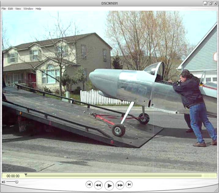

vshimsl(at)live.com
PostPosted: Tue Oct 14, 2008 7:33 pm    Post subject: hauling fuselage to hangar Reply with quote
Hello,
This is how I did it (picture below).
Let me know if the picture doesn’t make it. The video is over 30meg so I just pasted a screen shot. I hired a local towing outfit. The driver was the expert and I pretty much followed his advice. I am really not doing much as he had it under control.
The tilt bed is a no brainer. Mine is a tail dragger so your connection points will be different, again the driver should have a good idea about that. You possibly could tape a dolly or wheel onto the tail of your plane to make it a tail dragger for a day. Then attached the straps as shown. Oh the towing outfit had an electric winch. It was soo nice hiring out this part of the project that I cannot recommend any other way.
The guy that hauled my RV8 was so thrilled to be hauling an airplane that he gave me a break on the price.
Vince H.
RV8 - Finish

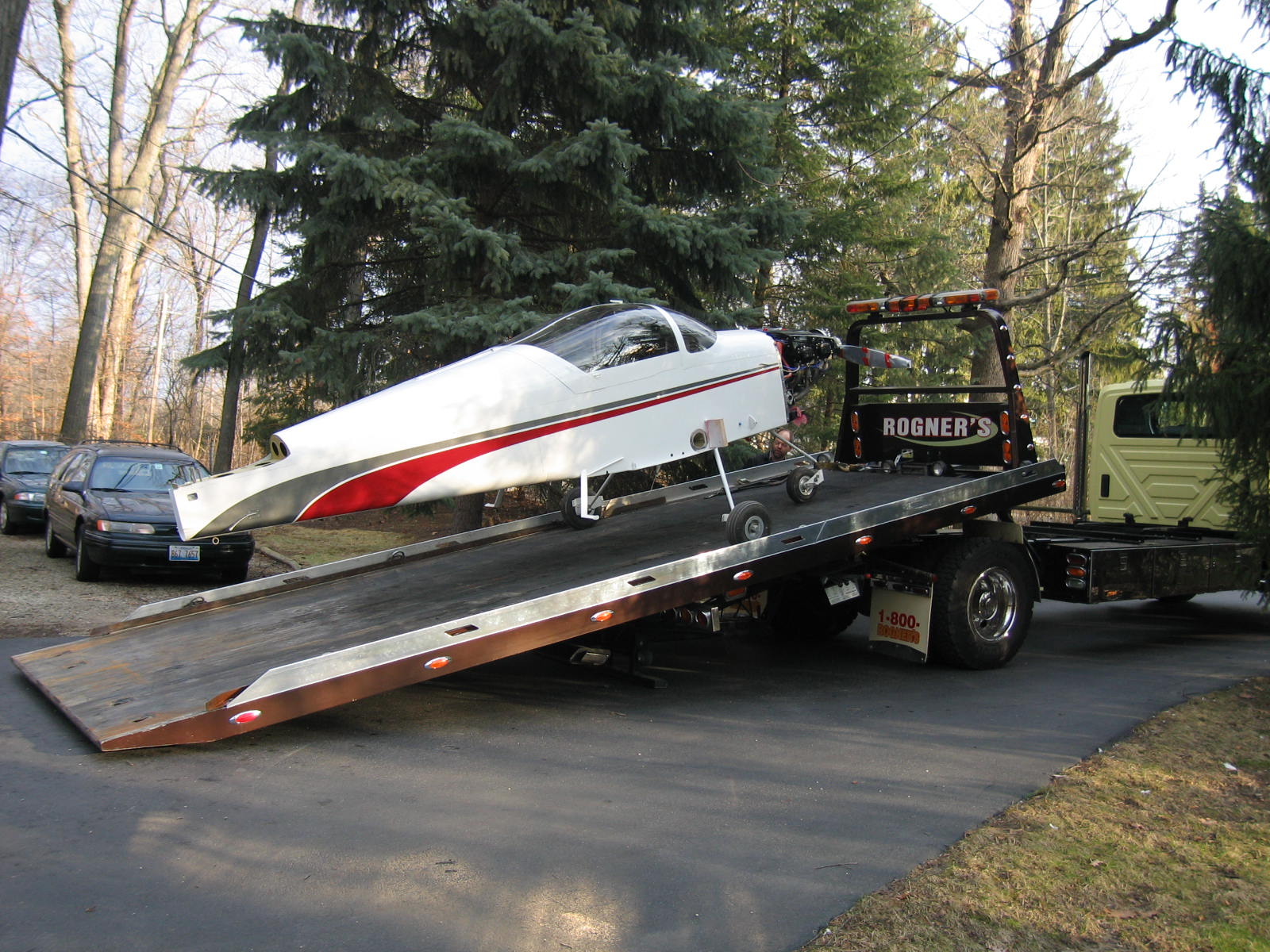

daverv6a(at)gmail.com
PostPosted: Wed Oct 15, 2008 7:39 pm    Post subject: hauling fuselage to hangar Reply with quote
Tom,
Used a wrecker - see picture. Just tied the cable to the front fork and eased it on. No trouble.
Tie the wheels down well, but DO NOT tie the tail down, have heard of fuselages being bent!
Dave Burnham
