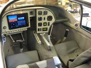

Jim
I used a couple of aluminum eye ball vents not in same position but the same idea. Pretty sure they came from aircraft spruce.
Paul
[img]cid:8105FF01-C0B3-4245-88F3-7AF55A2431C5[/img]

Jim,
I have installed these in the same setup that you have. http://www.aircraftspruce.com/catalog/appages/alumeyeball.php
My vent tube from the rear connected to an open space in the overhead just behind my head and I installed two of these vents....one for me and the other for my passenger.
Mike Duane A207A
Redding, California
XS Conventional Gear
Jabiru 3300A
Sensenich R64Z N
Ground Adjustable Prop
