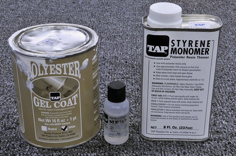

Hi Bill,
For my tail tips, I got some sweet gel coat stuff from the local Tap Plastics store. I bought a pt. can and a little tube of the hardener and some thinner. It mixes up like a really thick paint and you can either brush or spray it on. It isn't has hard as the stuff Van's uses on the tips, but it gives just as nice a finish. Pretty simple to use. Here's a picture of the stuff...
