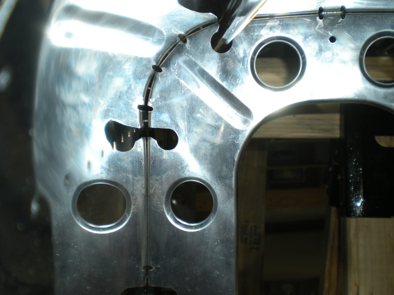

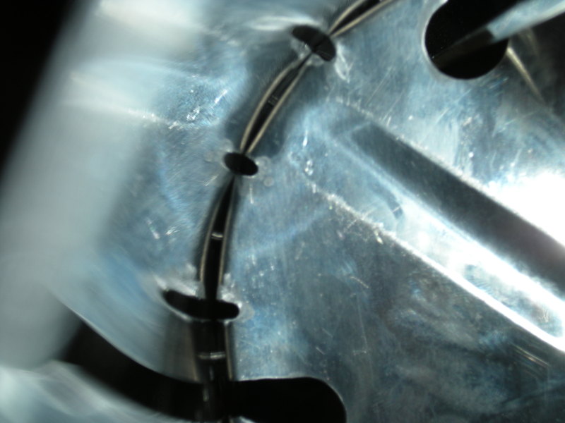

Hi Everyone,
Last night I managed to stay awake until 2Am working on the tailcone. Smile
I finally had to go to bed when I found this issue. The shape of the bulkhead flanges do not allow the flange to sit correctly against the fuselage skin.
I'm considering knocking off the corners of the flanges and letting it sit against the skins correctly, however I wanted to pick your brain.
1) Did you experience this same gap, or do I have poorly manufactured product?
2) How did you fix it?
Phil

This is where you use shims.  Take some .032” and .025” scrap aluminum and cut into small squares, say ¾” by ¾” but you can trim them to fit as needed.  Drill and dimple a hole in the center of the square and then prime.  Insert the shim between the rib and the skin.  In some places you will need to use two shims.
The shims make the difference in having a nice curve in the skin as it follows the rib instead of flat spots where you drove in the rivet (without having anything in the gap between the skin and rib as shown in your photos).
The rule is if you can squeeze a shim in between the skin and the rib, you need a shim.

I'm actually getting some small outward dents where the corners of the bulkheads are pressing against the inside of the skins.
Do I shim to the point where the corners are lifted from the skin? Or do I leave the corners pressing against the skin and shim the gap only?
I'm guessing option 1.....

For corners that severe you might want to so some minor rounding of the rib’s sharp edges using a scotch bright wheel in addition to using a shim.

I think If I remember back about 4 years ago...I saw the same thing and hand bent the tabs so they were rounded...this is not the only place you will run into this...I used the hand seamer on edge to make the tabs rounded so the skin laid flat across the bulkheads tabs. I remember because the tab center whre the hole is was too far for the cleco to reach and get a good grip...man the little things you can recall after four years..once you bend the tabs, run the whole thing across the scotchbrite wheel to make a nice smooth raduis for the skin to rest and remove any sharp edges for the tab to dig into the skin.

I saw this subject on VAF a while back. The discussion there went towards using liquid shim. Did you consider that? I'll be getting to where you are soon enough. Let me know. It's nice having an advance scout.

I can't remember either but I think Rick is correct. I would check the
instructions again. I think you're supposed to flute those tabs. Try
that first to reduce the amount of shimming required.

I remember doing that last year. Fluting is the answer.

I completed my tailcone riveting in Aug and fluting does help. I also used a rubber grommet while riveting to allow me to push the tab and the skin together and it came out great. If you decide to shim, recommend going the liquid shim route--you can use epoxy and flox quite easily to make the shim.

Were you fluting the edges of each tab? Just to bend them slightly away
from the skin?
I'm thinking of fluting and then using some epoxy and flox to fill the
gap during assembly.

I recall this step well and fluting the tabs helps a lot. However, some of the rivets still "suck up" the skin into rather unsightly indentations. This was especially noticeable around the small bulkhead just fwd of the aft deck.
The local tech counselor suggested lightly tapping a beveled 3/4" dowel with a sand filled mallet against the affected rivet shop heads. The indents popped right out and the skin is now flush. I didn't shim anything.

Thought I'd share you the feedback from Vans...
Phil
Phil,
File or hammer down the corners of the flanges so that they don't make
the outward dent in the skin, then shim the flange to make the bulkhead
fit the skin better.
Bruce
