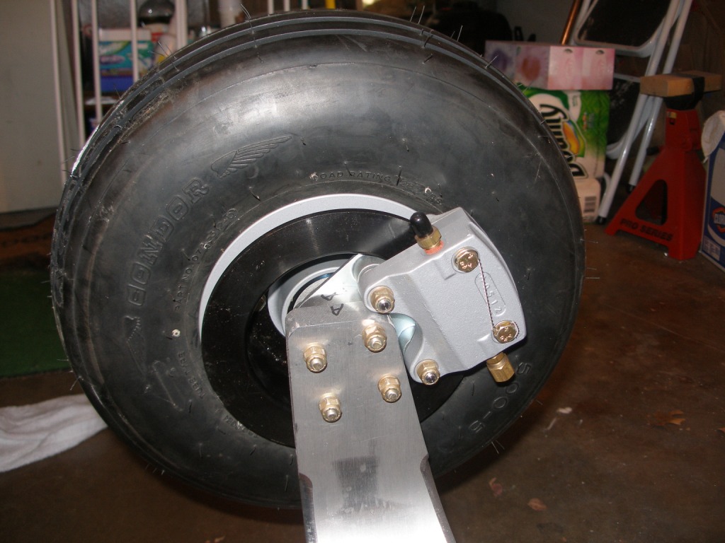

I tried to locate the pads to minimize the work on the gear legs. I just slightly rounded the end corners of the gear legs. I have attached a couple of drawings that I used to determine the location and orientation. The drawings are to scale; but to ensure the scale, the two random short lines must be exactly 10" apart. Let me know if you have questions.

Oops! Forgot to attach photos.

I put the flat side of the axle flush with the bottom of the spring
gear and filed off the corners of the gear just enough to allow
clearance for the brake assembly. (I have the Grove wheels and axles).
I just put the assemblies together and held them against the springs
to visualize how much metal to remove to get a good fit with the least
work.
