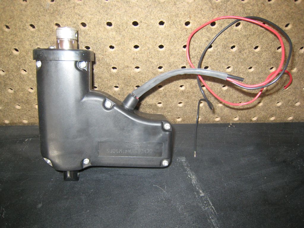

Because Zenith replaced the “open” flap actuator (with exposed micro-switches that you have to wire yourself) with a “sealed” unit where the limits switches are hidden and pre-wired (picture attached). Also unless there is some adjustment inside the casing on the new style actuator there is no adjustment.

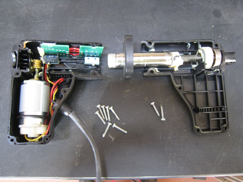

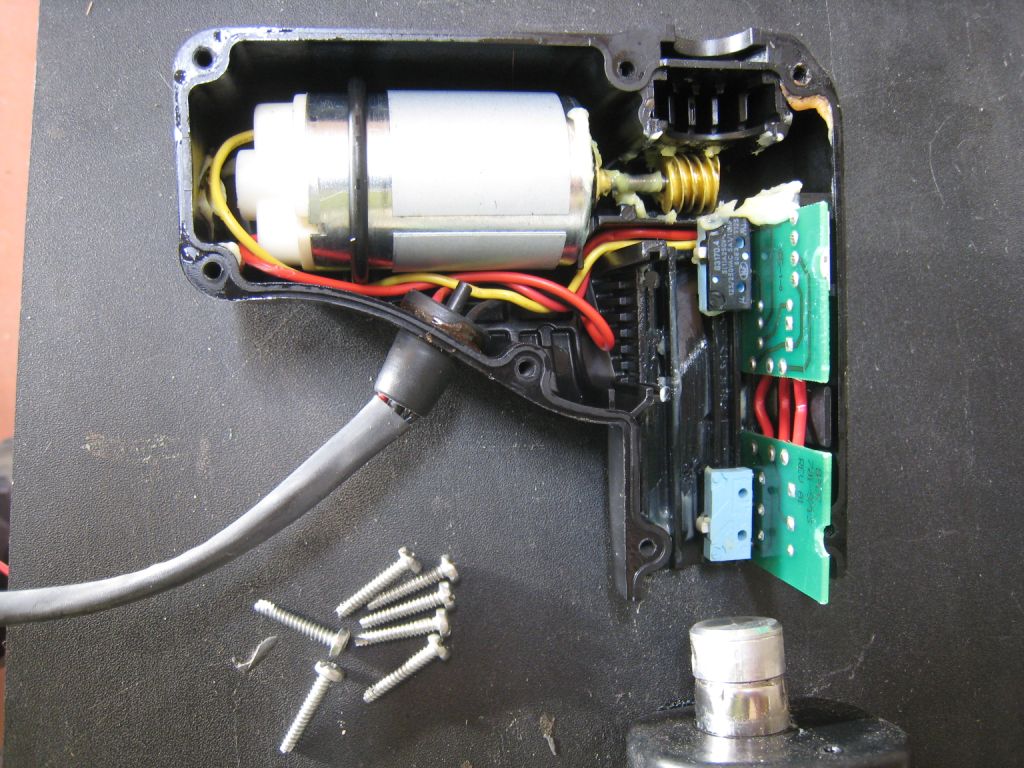

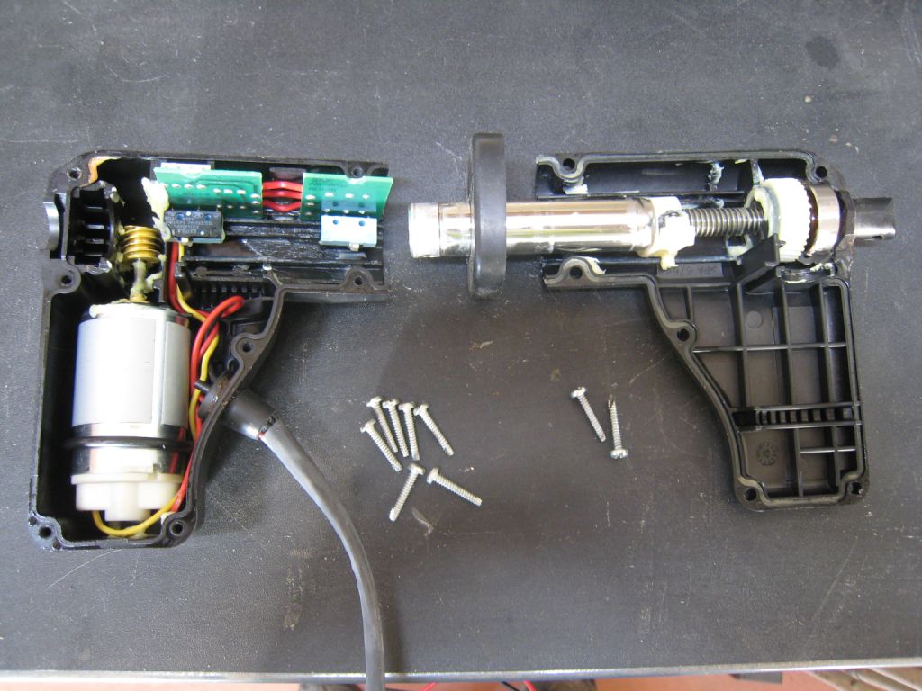

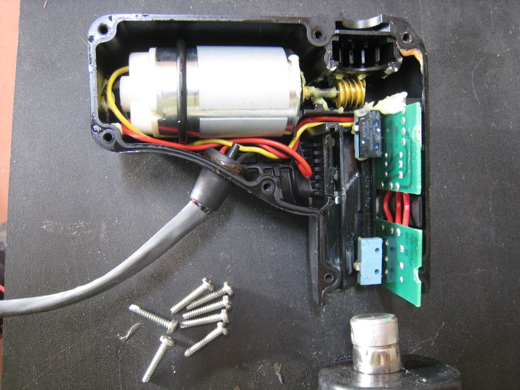

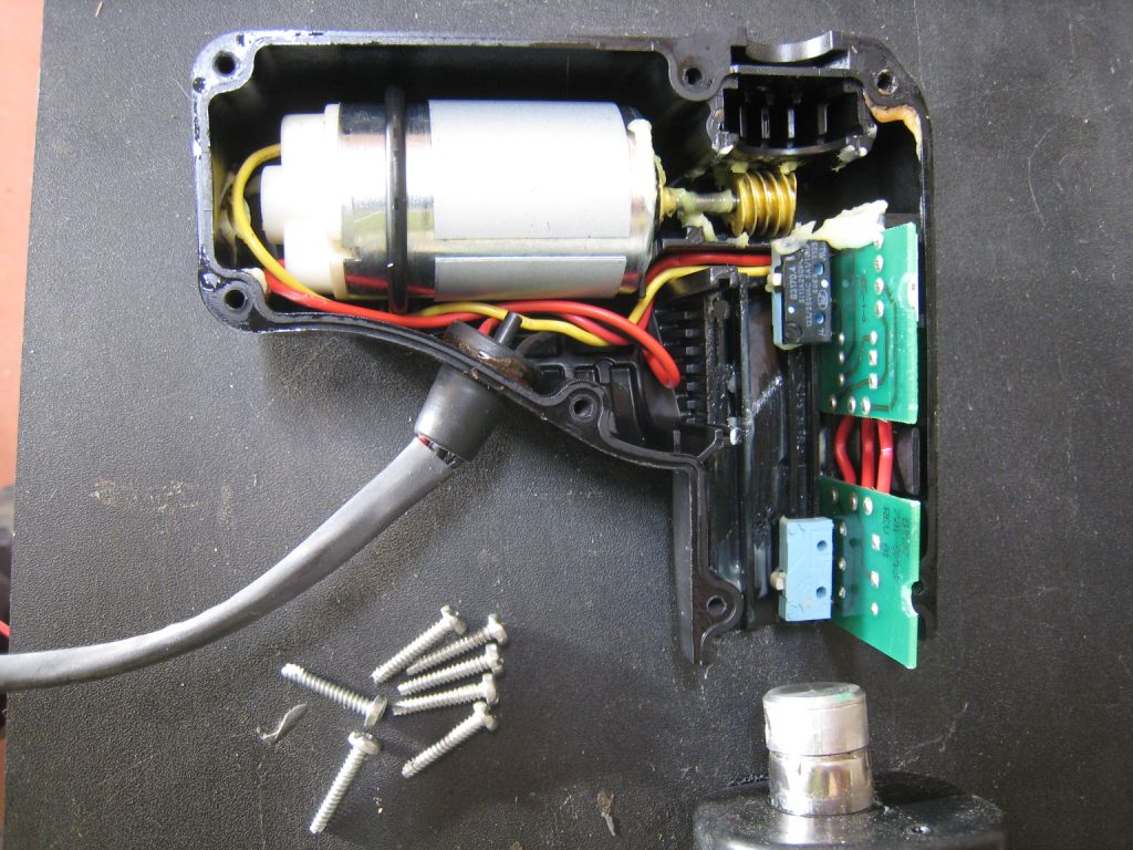

craig(at)craigandjean.com

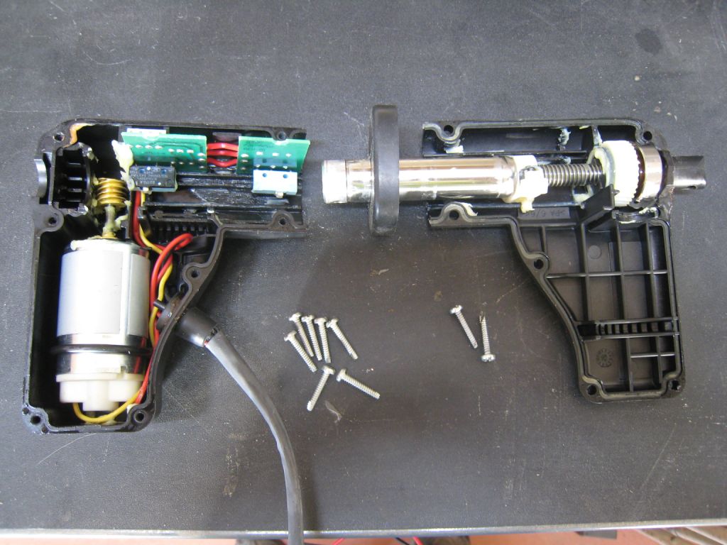

PostPosted: Sun Nov 16, 2008 3:07 pm    Post subject: Flap Switch Wiring Reply with quote
Here is what is inside the new flap actuator. The position of the limit switch nearest the motor is fixed but the one away from the motor is mounted on a circuit board that is glued into a channel. If you reglued it you could decrease the travel by up to about 0.5 inches. From the factory the travel is 2 and 1/8th inches or 54mm.
-- Craig
