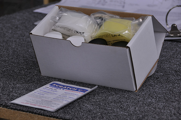

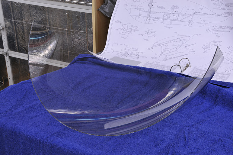

During the fitting of the Plexiglass canopy on my RV-8, I managed to put some pretty disheartening scratches in the windscreen section. You can see from the pictures that they looked pretty bad. A call to Van's revealed that a replacement canopy would be $640 + $250 shipping to California! Ack.
So what to do... A bit of surfing and I found this "Scratch Off" windshield repair kit for $35 on the Aircraft Spruce web site:
http://www.aircraftspruce.com/catalog/cspages/scratchoff.php
Frankly, it just seemed too good to be true. Nothing for $35 could be that "magic" I thought, but what did I have to lose at this point....
Well, the kit arrived yesterday and I decided to give it a try tonight. In a word: WOW! In about 2 hours the windscreen looked as good as new - no kidding - AS GOOD AS NEW! The pictures really don't do the repair justice. It looks better in person.

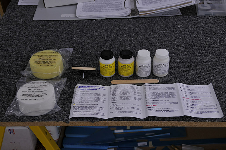

There are basically two sponges in the kit with four decreasingly porous pastes. You just put some of the first paste on the sponge and buff it in with a drill at 1200 RPM or less. Then you wash everything down good including the sponge and windshield with warm water. Then you use the next finer paste and repeat the process. Etc, etc, until you've used the 4th paste that is kind of like car wax.
Frankly, the scratches were gone after the first application of paste - I started at #2 based on the instructions and the "observed severity" of the scratch depth.
So, the bottom line is, if you've got scuffs or mild scratches in your Plexiglass buy this repair kit. It works!

Matt,
That is great to know. I just received my Scratch Off from vans
but have not broken it open. My 6A canopy has some slight scratches from
the rubbing of the sliding sun screen. The scratches are not deep but
they are long. I was thinking of starting with the #4 as I don't think
mine are deep enough to go through the whole routine.
In one of the photos I see a sneak peek at your proposed panel.
Looks action packed!
Robin
