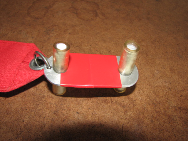

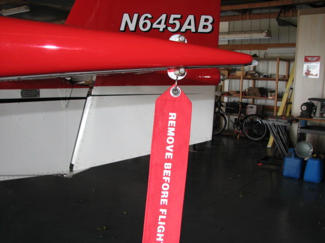

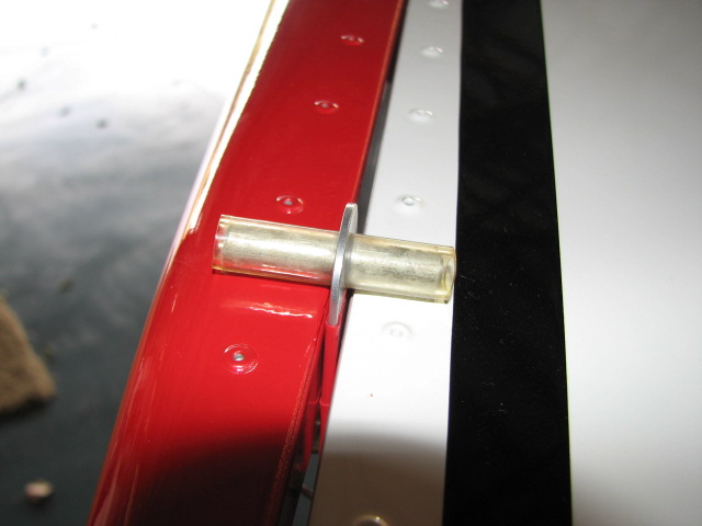

Simple Gust Locks-----(See Pics). Flat Alum., Alum rod, and plastic tubing. Push tubing over rod and drill holes in flat stock (Tight fight) and push rod with tubing over it through flat plate, add flag and your done.
